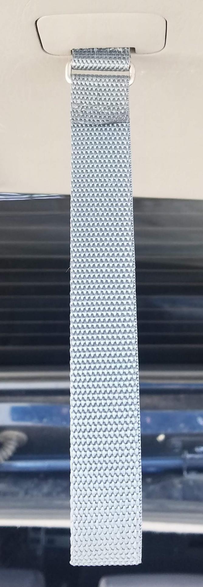

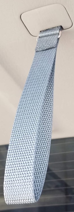

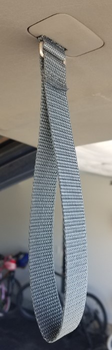

2004 4th Gen 4Runner Rear Lift Gate Strap Replacement DIY
My 4th gens rear lift gate strap (the one you pull down on) was gross, and even a little rusty. Checking online a company named Agency 6 sales replacements (that look dumb) for $20. OEM is hard to find, and expensive also. No thanks. Decided to make my own.
I went to a local store, bought some 1" strap for $2. It was really easy to remove the old strap, just pop out the plastic cover and remove the one bolt holding it in. Then I cut the old strap off the hardware, polished up the hardware, and hand sewed a new strap to the same dimensions as the old one. Just reused the old hardware. Whole thing probably took 20 minutes.
Looks way better than the Agency 6 strap, and costs way less.
