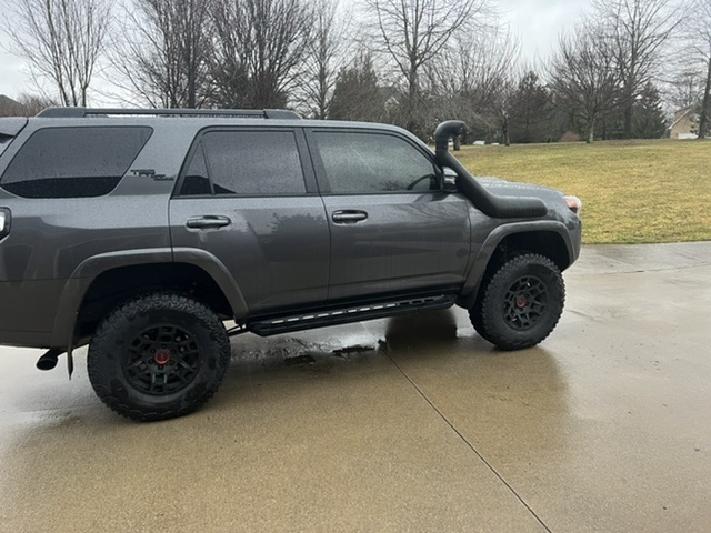

Im running 3” up front and 2” in the rear on mine.

Just do it right with extended travel shocks and coil overs and you’ll be fine. Im 3” up front and 2” up rear. My side to side is only off by 1/16” rear and about 3/8” up front, with no shim packers or preload variations or whatever other nonsense, and it drives and rides great on toad and off.
