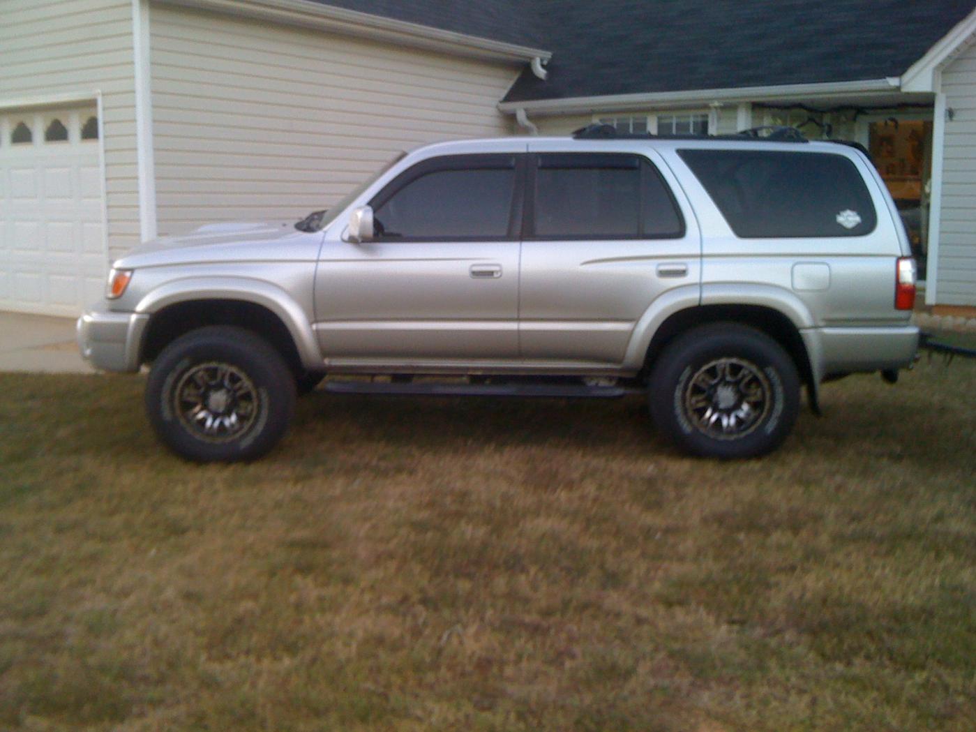

I put a BL on an 2000 a couple years back and it was extremely easy. Had a friend help me, we did it in around 4-5 hours. No, you don't have to remove the entire body from the frame. Follow 4crawler's write up and you are good to go. Before I did it I called a few places to get a quote on install, 700 bucks was the cheapest quote I received along with a bunch of whining about how much of a hassle it is and how long it takes. It's all a bunch of BS. Do it yourself if you are going to do it and you will realize how easy it is. All you need is a hi-lift jack and a socket set.
Yeah it's simple and cheap. Undoo all body mount, lift one side, slide in lift pucks, bolt them in and go to the other side. Then you just wory about sterring and shift linkage.
Here's the Toytec 2" lift for $170 Body Lift for 96-02 4-Runner - Toytec Lifts: Toyota Lift Kits: FJ Cruiser Lift Kits, Tacoma Lift Kits, Tundra Lift Kits, 4 Runner Lift Kits, Sequoia Lift Kits, Toyota Truck Lift Kits
