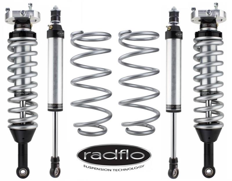

Radflo might be an option worth looking at.
Similar valving, but more options...
- You can get Standard or Extended Travel.
- You can get with Reservoir or without.
- Coilovers come Standard with a 600lb coil, but can upgrade to 650 or 700lb as well.
Their production lead time is quicker right now.
