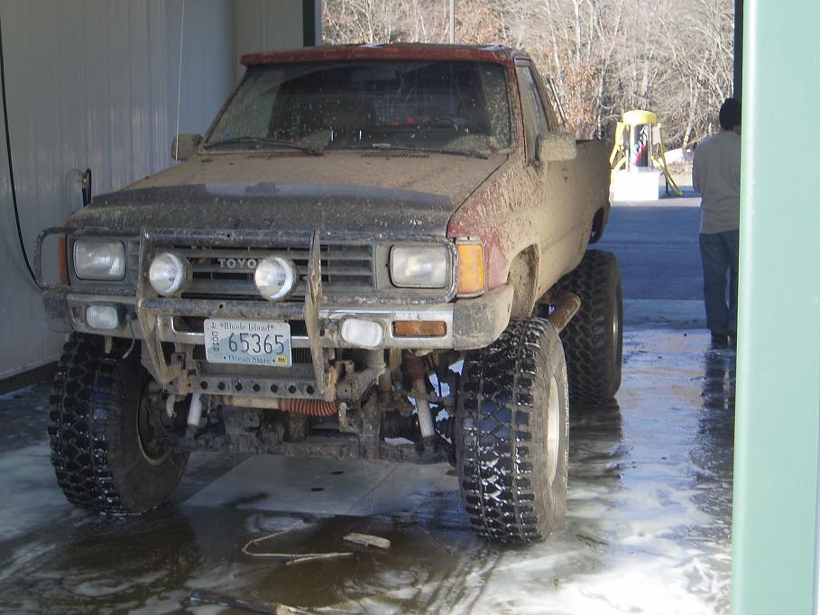

well id like to go wheel with u guys but i told myself i wouldnt bring the 4runner into the woods. i had an 87 yota pickup on 35" i still got the wheeln bug so ill prolly end up going with u guys sometime heres a pic of my old truck
oh yeah didnt notice youre in ri!
where in ri are you?? we just had a stocker run there yesterday.
come out with us sometime, we have trails for everyone :D
