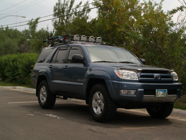

If you mount them on the lower bar of the rack you shouldn't get any mickey mouse look. Like I mounted 4 of them on the lower bar as seen here

Yeah for some reason my mounts wouldn't stay tight here is how I had mine setup I wish I would have taken better pics lol.
