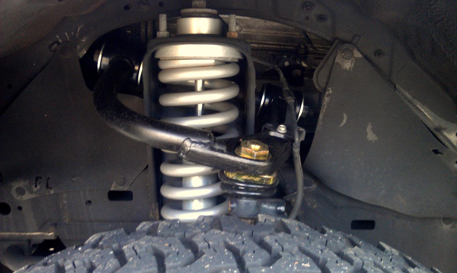

Here is just a pic if anyone was wondering what a 3" Toytec Lift looks like with the LR UCA. I was able to get the alignment PERFECT and not to mention it looks much better than the OEM that looked like it was streeeeeeeetching downward to make the UCA work properly. Enjoy!
Which setting did you set the UCA's on for the install?
If memory serves me....I had it right at the 0 (zero) setting with my set up. Worked out pretty well and getting the alignment was a little bit of work, but the hardest part was getting the VSC sensor setting to reset with the scan tool. I have had the alignment done at one other place and it "trips" the sensor when the alignment was adjusted and the tech had no idea or did not have the proper scan tool to reset it. At the time....I didn't know there was one and had to go back to the dealership to learn what had happen and pay the $$$ to have it reset.
