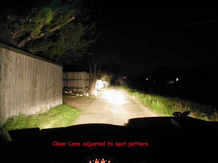

LightForce 170s Installed - Well, Almost
Last photo for all y'all. This is the spot pattern. Very minor position changes sweeps the position of the spot here.

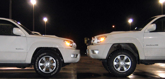

You are right, but they are still back to where I have to lean the lights forward to open the hood. Remember though, with my 3" lift, these lights are way above all other bumpers.

Awsome pic showing same model/color 4runner lifted. Are they both yours? I would love to get a daytime pic like that to show my wife what a difference 3" makes! Do you have that one large by any chance?

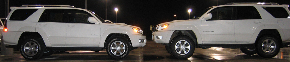

I've posted versions of these before, but I can't find them in a couple searches. Here are 3 side by side photos taken at a local dealer.

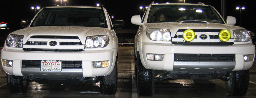

Front
Remember though, I think that the Donahoe lift makes the 4Runner look even better.

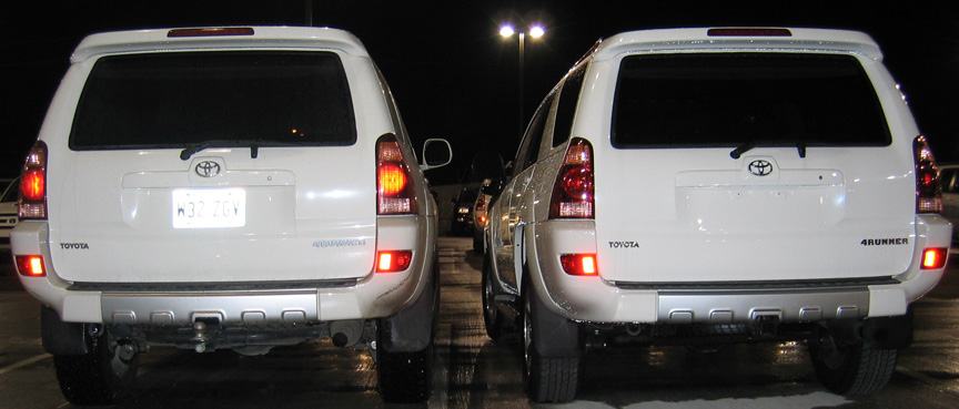

Rear photo. I think the angle made it harder to see the difference. Maybe I'll take some new side by side photos this week. If so, they will be posted in a new message.
