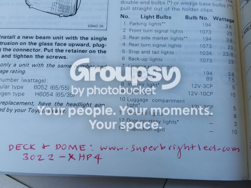

Anyone have an interior diagram of a first gen?
I have an 87 and the lighting sucks. Looking to upgrade it all to LED.
Just wondering if anyone had a chart with locations and bulb sizes. I had one for my 3rd gen but that won't help me now

I understand that. Just looking to see which bulbs are where. I know the cluster has 3 194 bulbs in it. Just wondering if there was a list somewhere that had all the bulbs before I tear the interior apart and have to find them on my own.
Would like to have them all ordered and in hand so I only have to tear it apart once

FOund it. Owner's Manual...
20160215_113826_zpsd2zf4dqa.jpg~original
Any info on gauge and dash? I know there are 3 194's in the gauges and 2 in the inclinometer. My bulbs in the AC etc haven't made it the 30 years like the others did
