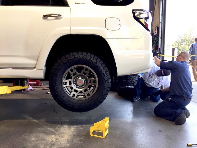

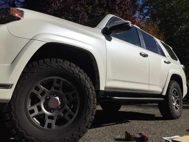

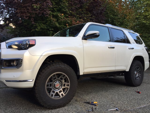

First order of business is TRD wheels and new tires.
https://flic.kr/p/XdZLLY
^^^Matte gray TRD Pro rims with BFG 275/70R17 tires.

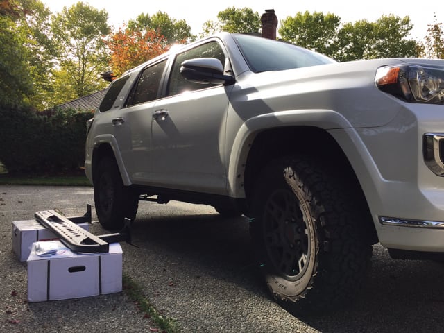

Also almost 100% sure I will be going with the SW sliders with dimpled tread plate + textured PC. Just haven't pulled the trigger on that one yet. One thing is for sure, this truck is a LOT higher than my old Explorer. It's a bit awkward taking a huge step up into it and shimmying into the driver seat. Having the SW sliders on there should help me with that :)

Received Pelfreybilt front bumper which is now sitting in my garage awaiting install. Just waiting on a couple more parts (winch and flipster plate holder) and some free time to install. I also pulled the trigger on SW sliders and Pelfreybilt rear bumper but those will take a while to get here.
For the front bumper I ended up getting the PRO version since I plan to delete the front emblem (or perhaps swap in the classic emblem as many have done), so I also had to pick up the PRO version of the upper grille insert. Debating whether to paint the grille insert graphite metalic to match the wheel color.

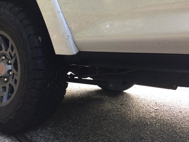

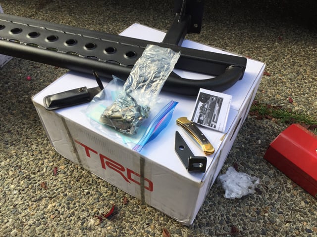

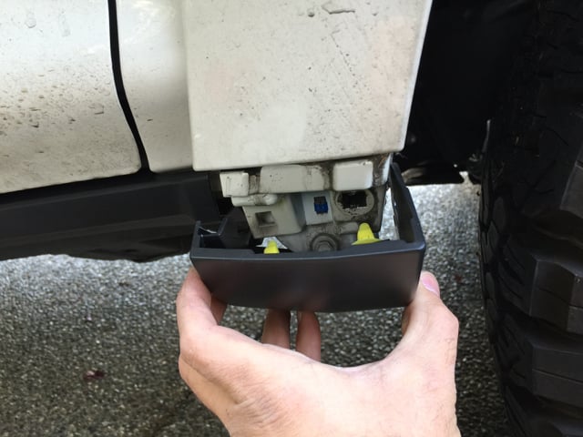

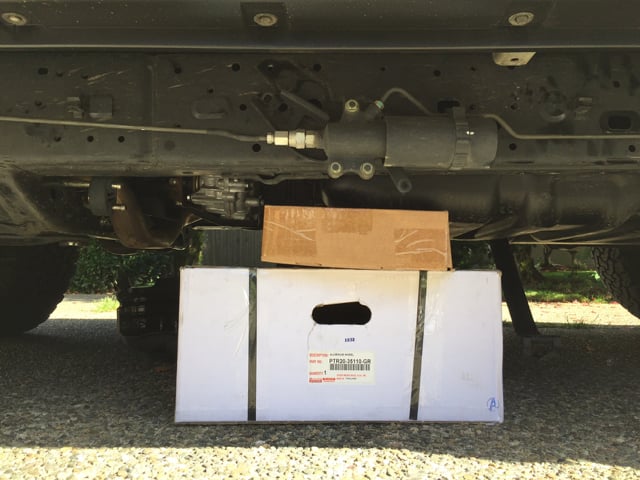

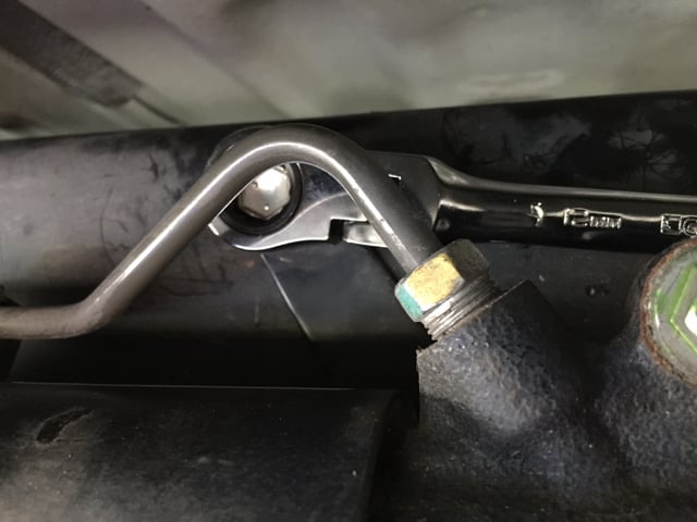

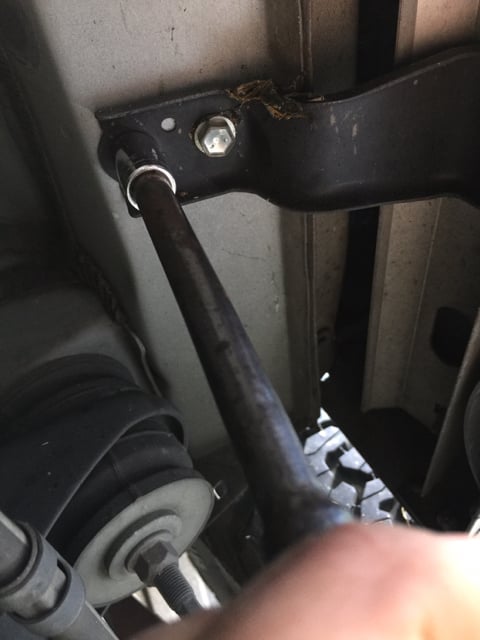

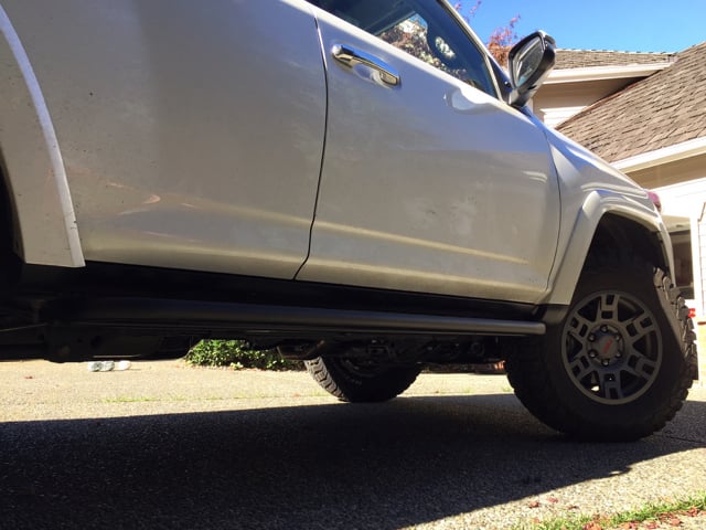

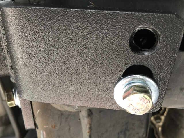

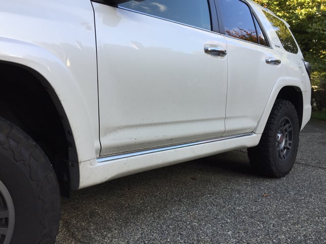

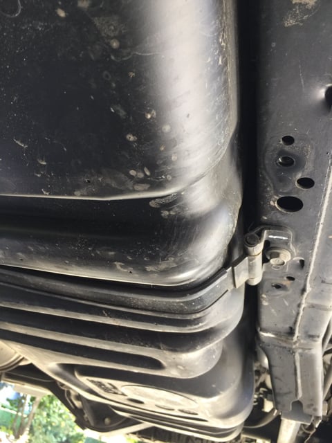

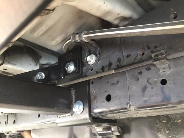

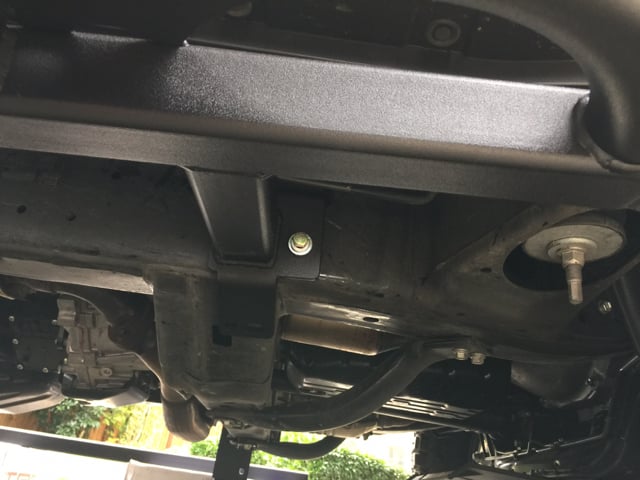

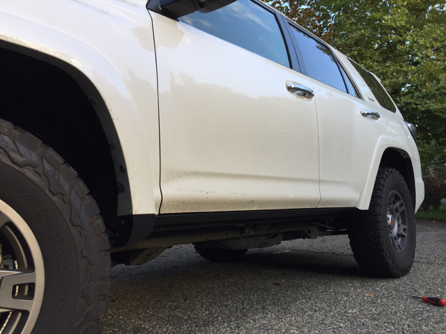

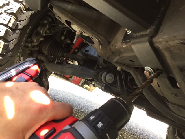

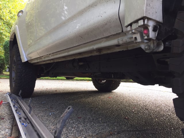

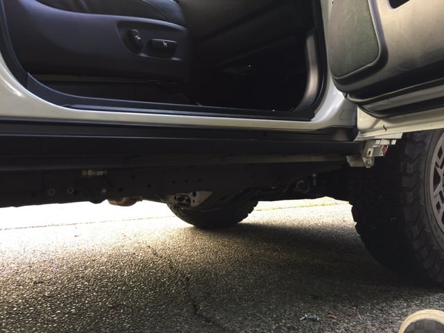

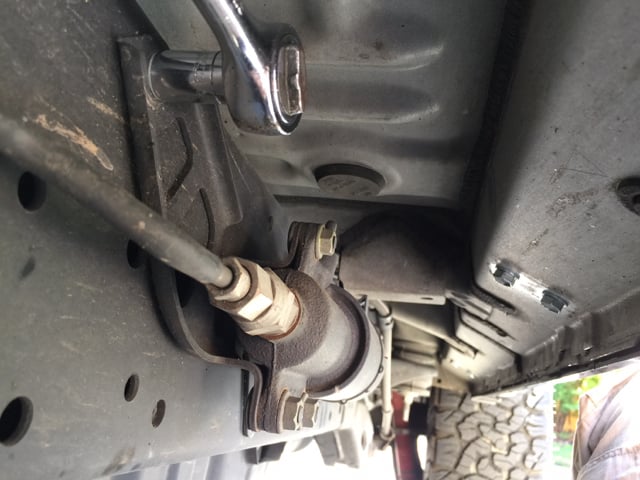

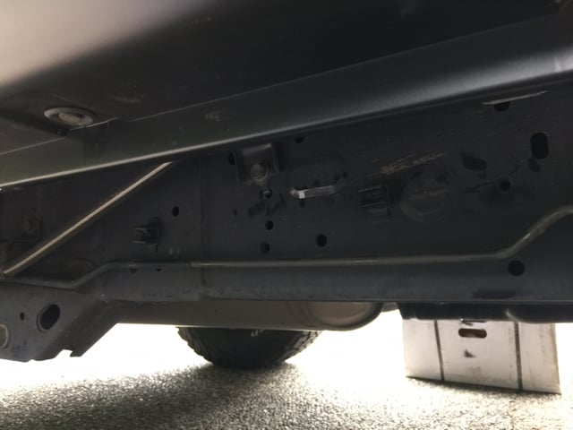

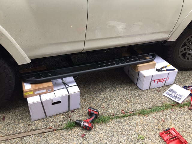

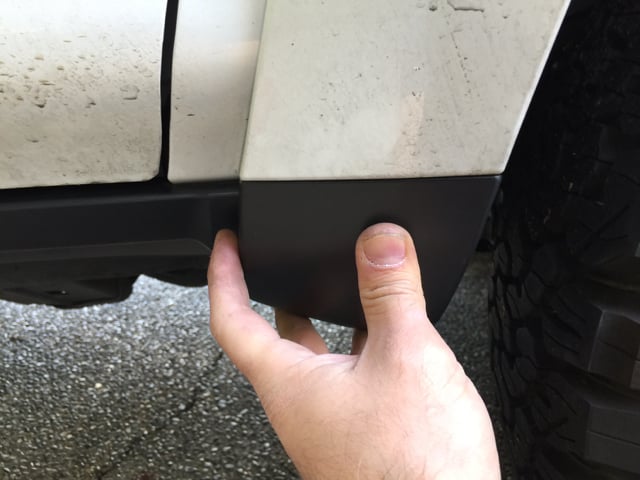

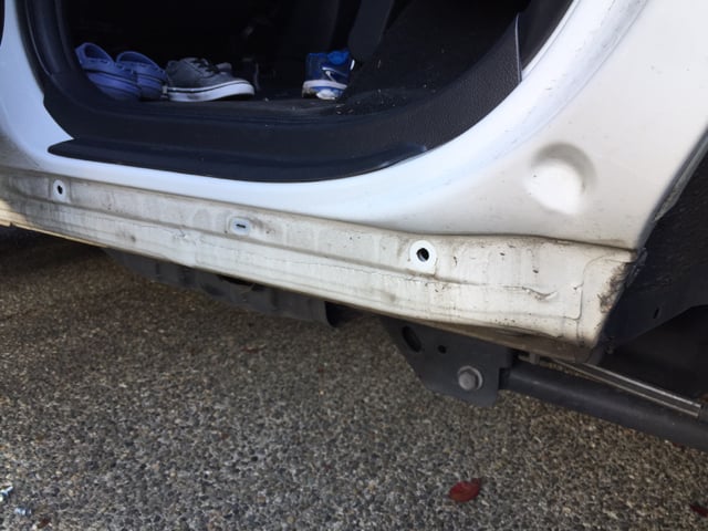

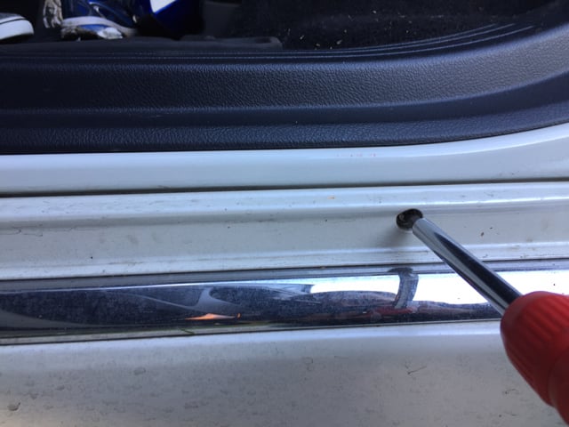

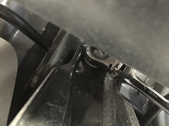

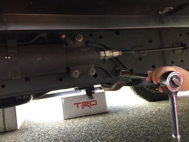

Finally getting a chance to post some updates. A few weeks ago I did the trail conversion (OEM rocker trim) and installed the SW sliders. I was super happy with the install, although I did have to drill 3 holes in my frame, which I was not anticipating in advance. I guess the newer frames don't have as many holes drilled from the factory.

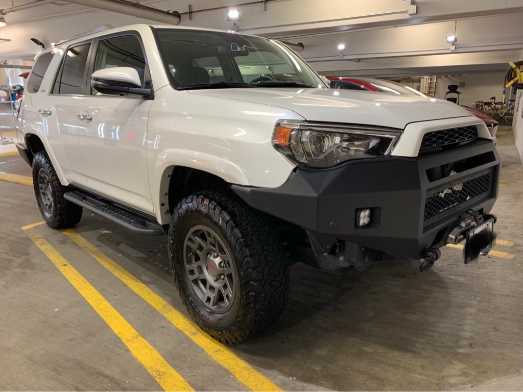

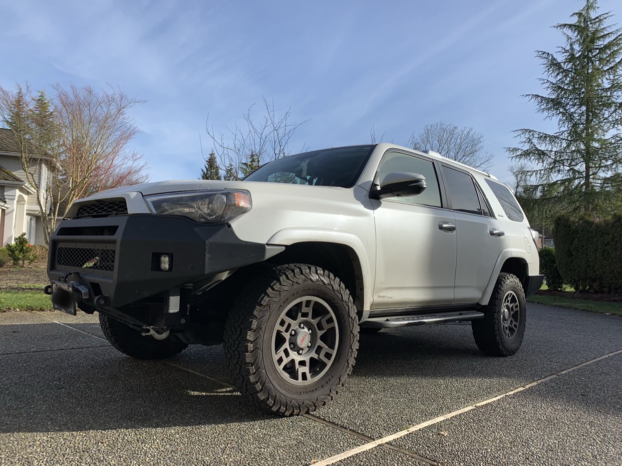

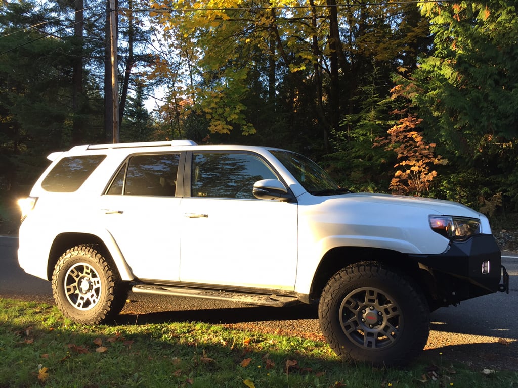

And then the following weekend.... I got the front bumper finished (mostly... still might do some adjustments).
Just downloaded tapatalk on my phone to make posting pics easier. See forthcoming posts for pics. Thanks!
I've had the bumper on for a few weeks. Here's a more recent photo. Updating OP to include latest photo.

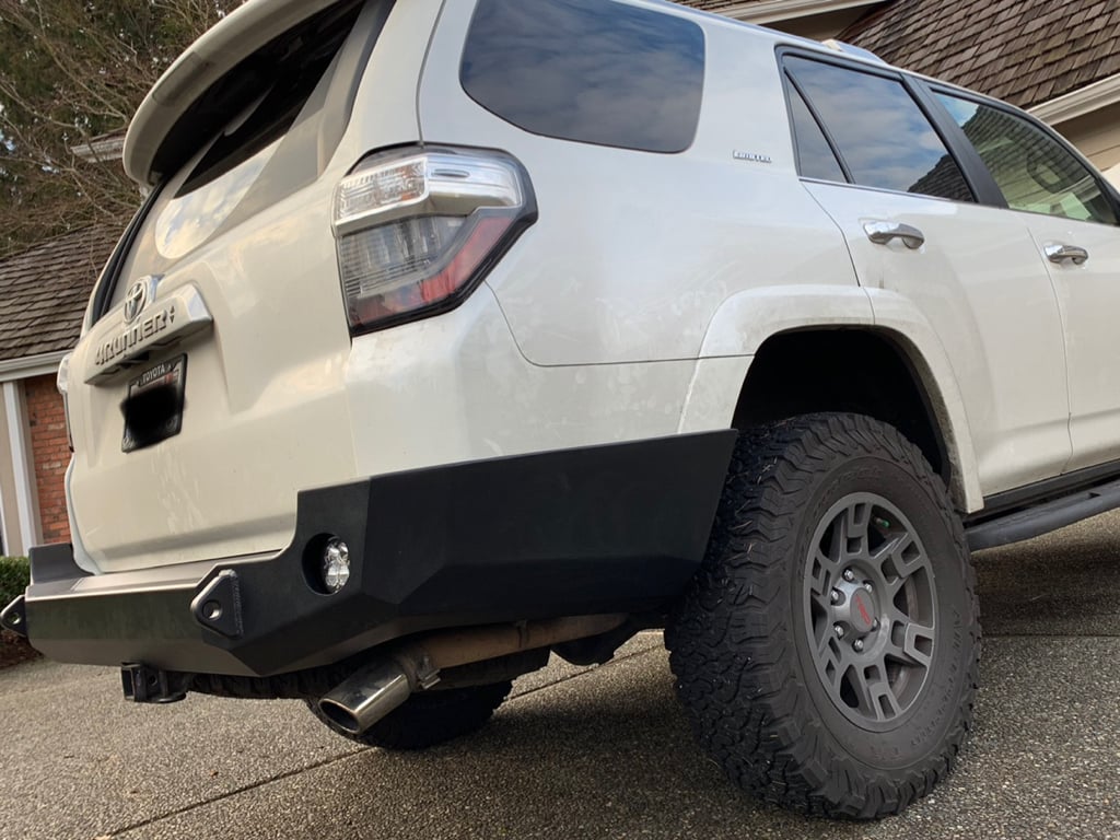

Finally got my rear bumper done. After waiting forever for the Pelfreybilt rear and then getting hosed in the end, I opted for the ExpOne rear without swing arms. Really high quality (better than Pelfreybilt was?) and not too expensive. Really happy with results.
I also put in daystar rear spacer lift to compensate for added bumper weight and to get a little more rake back. Front still has SS spacers that we’re already installed when I bought the truck.

Thanks!! I did the Trail rockers and I’m glad I did cause it came out perfectly. The SW steps are very high quality. One of my favorite mods so far. Functionality is perfect for my purposes. They also saved me from body damage in a parking garage when I side swiped a concrete pillar. They stick out just far enough to protect the entire body from vertical obstacles. A little sanding and a few sprays of satin black spray paint made the scrape on the sliders look new again. Install was not too hard but I had to drill at least 1 hole in the frame. I guess there are holes on some frames that not everyone has. But install wasn’t too hard. On the limiteds, you have to remove the XREAS lines and reinstall them after, but it’s doable. Overall I would recommend the SW sliders though. Definitely do not regret getting them. That’s awesome of you live right by their shop, you can save on shipping costs!
One more thing to consider. If you do a trail conversion and put sliders on a limited, you’re definitely going to want to do bumpers eventually too, since the limited bumpers come down way lower then the other trims and the trail conversion will make the middle of your truck a lot higher and tucked up, which looks weird if you still have the stock bumpers. I think you can get a glimpse of this if you look back at some of the photos of my SW sliders install. I did that install before I did the bumper. But I was planning to do bumpers from the beginning.
