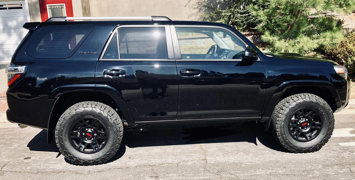

OP, Snoranger’s limited 4Runner tire size works out to be 32.61” tall with a 265(10.43”) width. This narrow, tall tire provides better rolling resistance, but, due to the height reduces torque and will feel more sluggish and reduce mpg. A 285-70-17 looks great and works out to be a 32.71” tall tire with an 11.22” width, but, will be worse on mileage and power by about 1.5-2mpg over a 265-70-17. I run a 275-70-17, (32.16” x 10.83” width), and IMO, think it is a perfect overall size for looks, mpg, power, etc. Speedometer/odometer is only off 1.8% over my factory equipped 265-70-17 (31.61” tall x 10.43” width). Not worth recalibration in my case. You can also still fit a 275-70-17 under the truck in the spare tire location as opposed to a 285-70-17. Pic of my 4Runner with 275-70-17. Stock TRD Pro height, which, is 1” taller than other factory 4Runner suspensions. Tire sizes will vary slightly from different manufacturers. Good luck with your decision.
