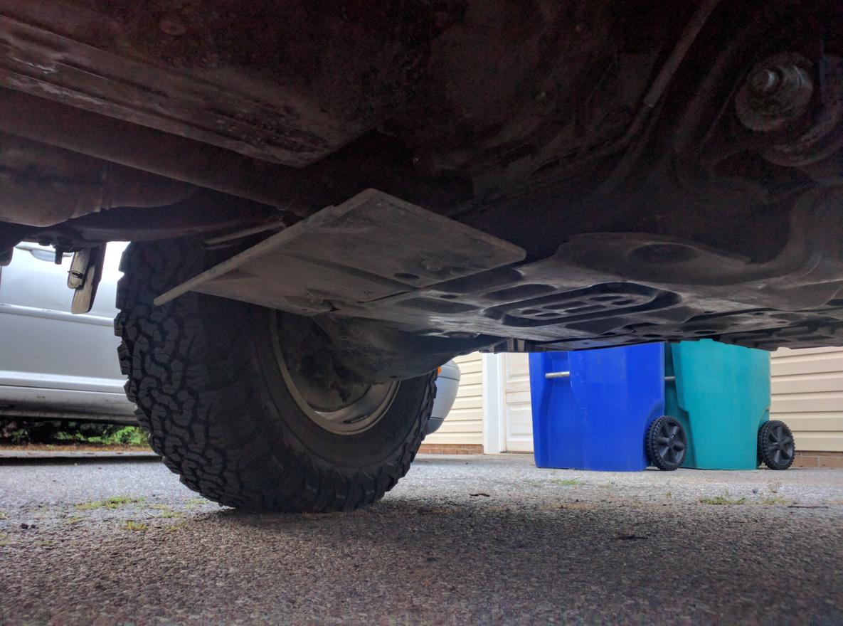

The "ground clearance" is the same, you are referring to the body panels hanging low. That front bumper in the 14+ LE is stupid low, not even getting to the braces look. The only armor difference is if they are still putting the half skid on the gas tank, otherwise the LE has skid plates?
Correct - good call. Same clearance I was referencing the body kit. No front skid
Not that I've crawled under to inspect, but my paper brochure tells me the SR5 and LE have the same skid setup, depending on whether it's 4x2 or 4x4.
My LE absolutely has a front skid -- I'm not sure what you're talking about...
Crappy pic, but you can pretty clearly see the skid continuing to the front.
I had a half fuel skid, though.
