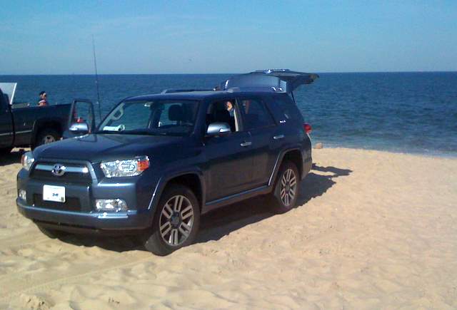

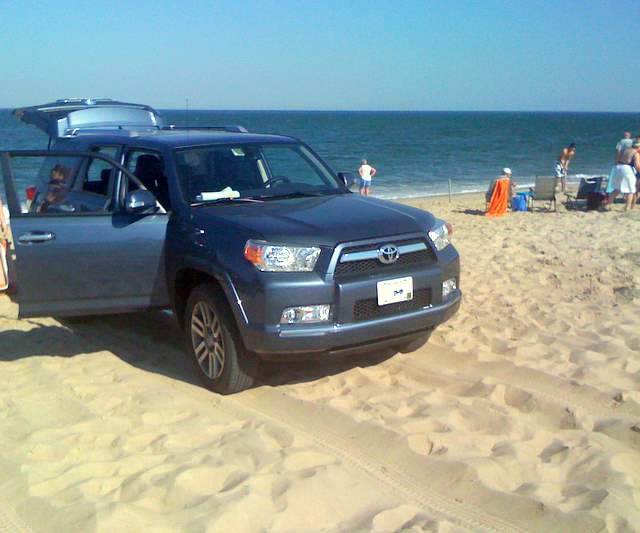

Ventured out on the beach over the weekend, aired down the tires to 20psi each and had zero troubles in the sand. The 4runner performed perfectly! Now have to give it a bath in this 98 degree weather...it is filthy, but well worth it!!!
Here are a few pictures:

Very cool. What beach were you on? The sand looks fairly deep, but maybe not as deep as others... What kind of tires do you have and are they they stock 245s? Also, did you have an air compressor to reinflate the tires or just drive somewhere to inflate them...?
Nice pics too, BTW.
Nice pics too, BTW.
They are the stock tires, I believe they are Bridgestone. The beach was located at Cape Henlopen State Park in Lewes, Delaware. I usually visit this beach due to the convenience of access points to drive on and when you drive off they have air compressors (avg 2 per access point). Really convenient.

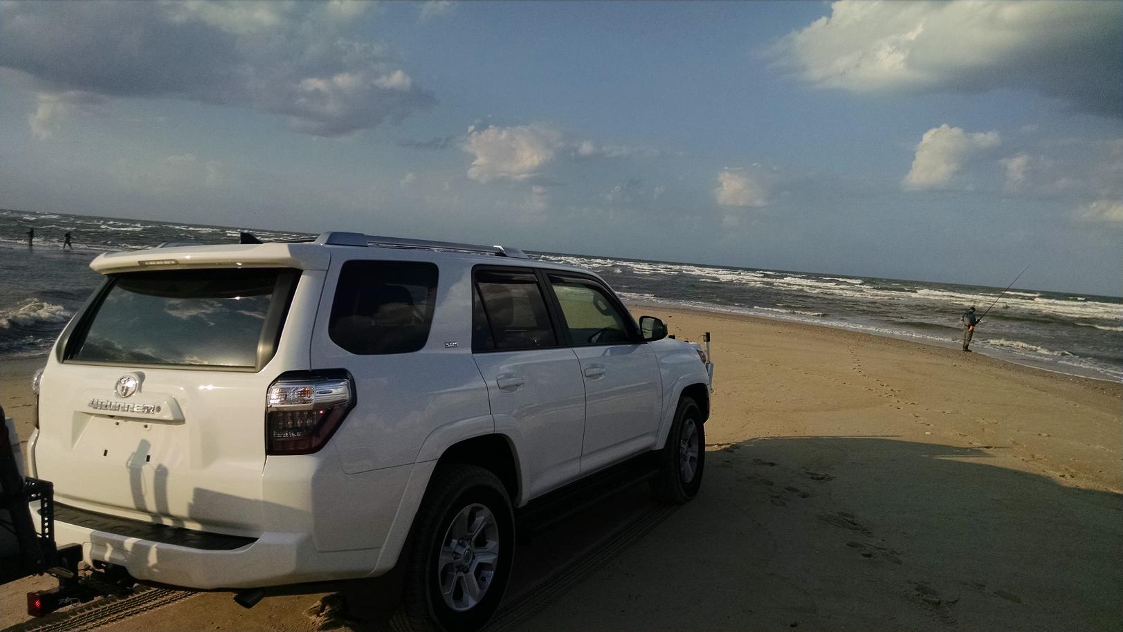

This thread on another forum might help you out. I'm on my 3rd 4Runner and have been driving on the beach and sound side of Bodie, Hatteras and Ocracoke Islands for decades.
BTW stock tires on my 2016 SR5 aired down to 18-20 psi, 4H with ATRAC and VSC OFF works just fine. Operated my 4th Gen similarly.
Agree on very low pressure. You can easily loose the bead seal on a tire with a sharp turn or having the tire grab in the sand and the rim turn in the tire. Seen it happen.
Also aggressive tread is actually a detriment in the sand; they tend to dig in rather than role over the sand.
Picture is at the infamous Cape Point. the very tip of Cape Hatteras, Graveyard of the Atlantic.
