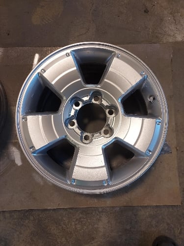

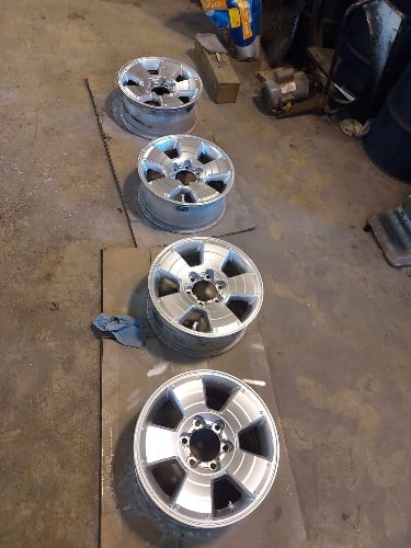

I just did my 2009 tocuma rims. As they were oxidizing up. I wet sanded 220 uses seim primer then just after wet sanding again 400 I used a dupicolor titanium grey on them. They have some imperfections as I didn't spend weeks sanding things to be perfectly smooth. :)
I think your color choices will be fine. I just wanted these rims to look similar to what they did and they match their hubcaps. :)
