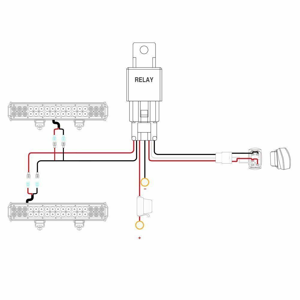

I'm not sure to be honest. I tried looking up the difference between the two but I am still not sure. This is the harness I used hopefully you'd be able to tell by looking at it? If not, and you are willing to tell me how to figure it out, I would definitely get on that asap. Thank you.
Amazon.com: Nilight LED Light Bar Wiring Harness Kit 14AWG Heavy Duty 12V 5Pin Rocker Switch Laser On off Waterproof Switch Power Relay Blade Fuse-2 Leads,2 Years Warranty: Automotive
Eh, can't really tell from that. Most of those are positive switched, but can you post the wiring diagram that came with it / what you did?
Found the diagram online.

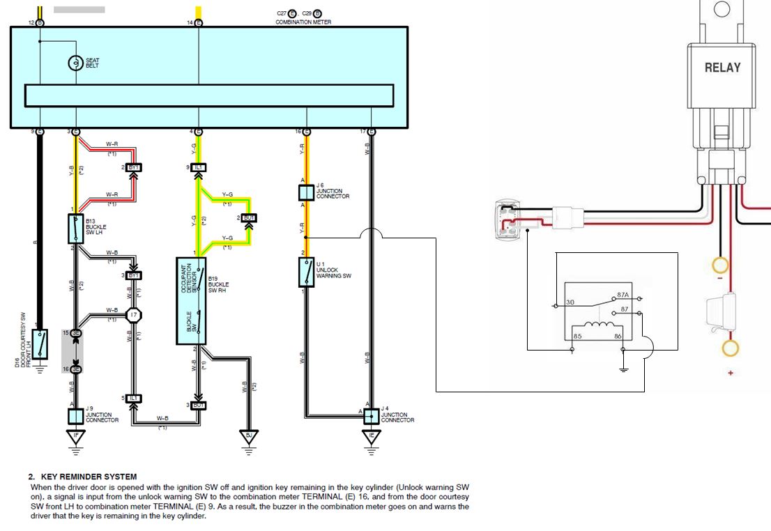

Going to make a guess here - if that grey wire from the switch measures as a switched +12V, use the following diagram. This is from a 2000, so the wire colors could change... If the grey wire from the switch measures as a switched ground, skip the relay and wire directly to the unlock warning switch.
This will make the lights appear as if the key were still in the ignition - with the ignition off and the driver door open, it will continue to chime even after the key is removed.
Thank you! This is perfect. I will get on this and let you know how it went. I appreciate you taking the time to figure this out for me.
