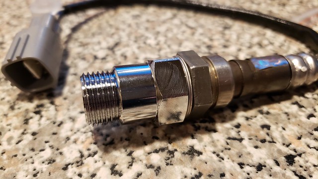

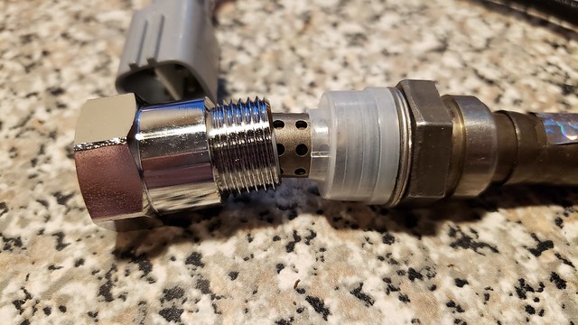

Infamous- replace or do the $5 mod

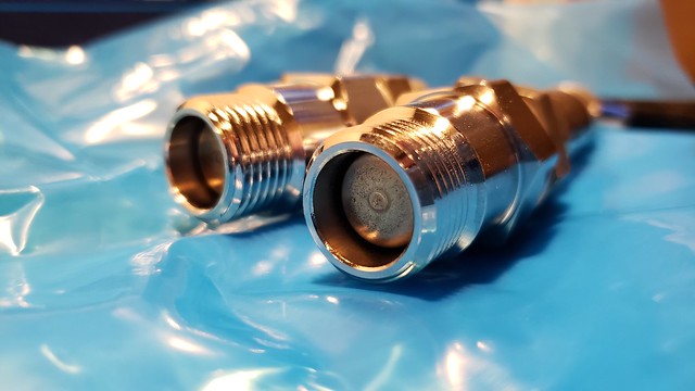

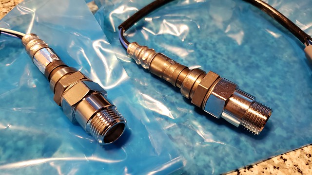

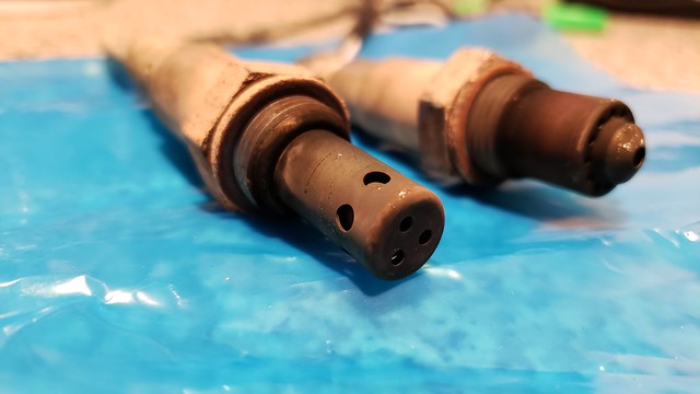

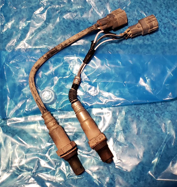

As for the P0420 code, I'll be replacing both downstream 02 sensors- RockAuto has them for pretty cheap, and honestly I just need them for passing emissions this next month.

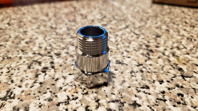

Would it be worth purchasing the "CEL fixer extenders" as well?

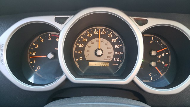

Just went on a long drive. Speeds from 30 to 75 mph on local roads and highways. Engine at operating temp and some interesting things happened that I noticed. She hit 210,000 and no CEL has come on.
1. Acceleration is much quieter and smoother, there's no lull then pick up, it seems more linear.
2. Idle is smoother
3. When I let off the throttle after hard acceleration, there's way less crackle in my exhaust (I have removed a cat, replaced the exhaust with Magnaflow, and have no resonator)
4. My MPG after driving slow, sitting at stop lights, and on the highway for a number of miles has seemed to settle at 15.9 (before it was 11.8, even after my last computer reset and test drive before replacing the o2 sensors)
5. The vibrations on acceleration and at cruising speed have calmed down. Before the exhaust would drop to a deep note and shake make the interior rattle.
6. When starting the vehicle, the RPM doesn't jump up and sound like a rev. Plus it fires up more quickly then before it seems.
Could all of the changes I have experienced be opinionated, argued, and debunked? Perhaps, but it's what I've noticed after driving this morning before the work and after completing the work. Then again, I also just completed my overnight rotation and I'm pooped lol.
