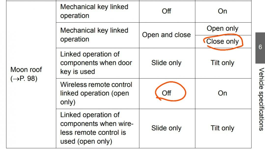

Can anyone confirm if the circled options are still available on 2019+? I wanted to change them, but could only find the tilt/slide option with TechStream.

Please! Someone?

so i got the obd reader and dled the app on my phone. i was able to change just about every setting i had wanted.
the only one i didn't see that i wanted to change was opening all windows with the key function to open the sunroof to a tilt instead of slide open.

I'm also interested in having the sunroof to a tilt only instead of sliding open
i believe it will only be able to get changed at the dealer. maybe they have a few more options they're able to change.
i went through all of the categories on the app and double checked for the sunroof tilt option
You need Techstream to change that setting. I sent a debug log to Carista, and they confirmed their software couldn't see that option. I did find a guy with Techstream to change it for me though. Also, what year is your 4Runner? Mine is a 19, and I couldn't unlink the sunroof from the windows, only could choose between tilt or slide.
