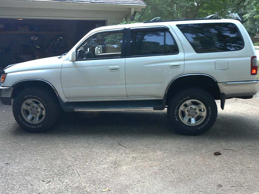

Here is a pic of the lc and stock. I got the TRD setup installed in the front yesterday. It is still making a noise when turning right. Sounds like it is coming from the back. It's not loud but sounds like something is rubbing barely.

I thought it would be funny to post the pics of LC/Stock.
That's awesome. The pic makes it look like you're in a constant state of nose dive from slamming on the brakes.
