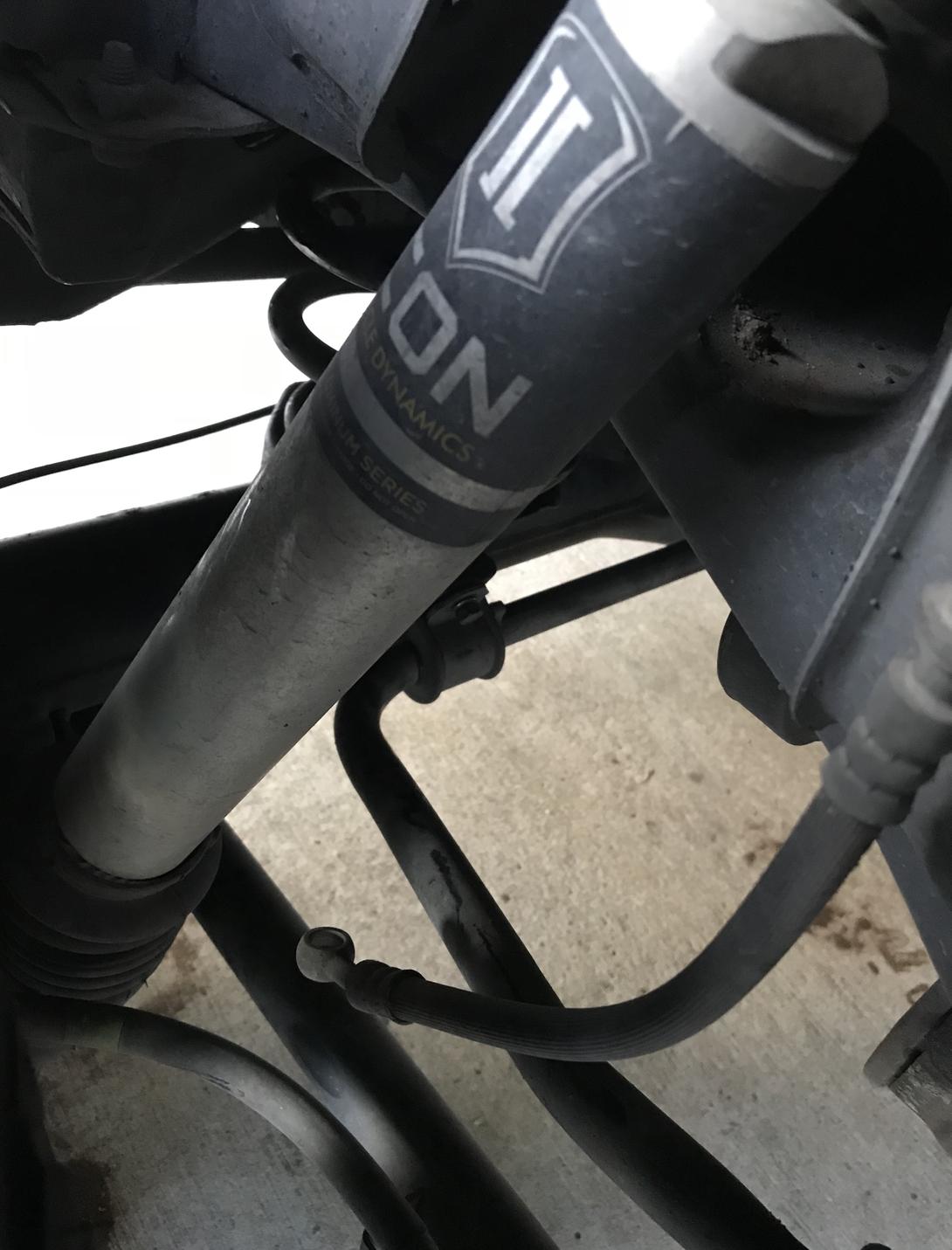

For the record, there’s not even half a leaf on the shade tree that I wrench under, which leads me to this question. Got t-boned on my rear wheel several weeks ago, leading to insurance paying for the replacement of a bent rear axle, among other things. Got the rig back 4 days ago, driving with no issues, until today, when all of a sudden my ATRAC/ABS locks up on a corner turn and I’m dead in traffic for a few seconds, then able to drive but with a a weird clank coming from every rotation of the rear wheel. Got to safety, checked the wheel, thought maybe I’d jack it up and take a look behind it, but it turns out the shop used my lug key and didn’t put it back (I’m an ass for not checking, I know). Then I find this hanging loose behind the wheel, and I can’t figure out what it is/where it goes. Tried search functions to no avail, most likely because no one else is as ignorant as I am about simple mechanics.
Can anyone tell me what the f*#k I’m looking at? Right rear wheel. Thanks in advance for advice and/or molotov cocktails.

Its a hydraulic line from the XREAS system that you had, it was connected to your OEM shock. It'll probably be fine if you leave it, but you could also remove what's left of the XREAS system to get it off your truck.
Dude, thank you so much. The Icon was put in before I got the rig, so I had no idea. I really appreciate it.
Yep. I'll second that. Those hoses aren't a problem - I drove around for maybe 75,000 miles with them disconnected and zip tied out of the way after I got my first lift. I finally just cut the whole system out when I put on my new shocks and springs.
But that still wouldn't explain the issue you just had.
