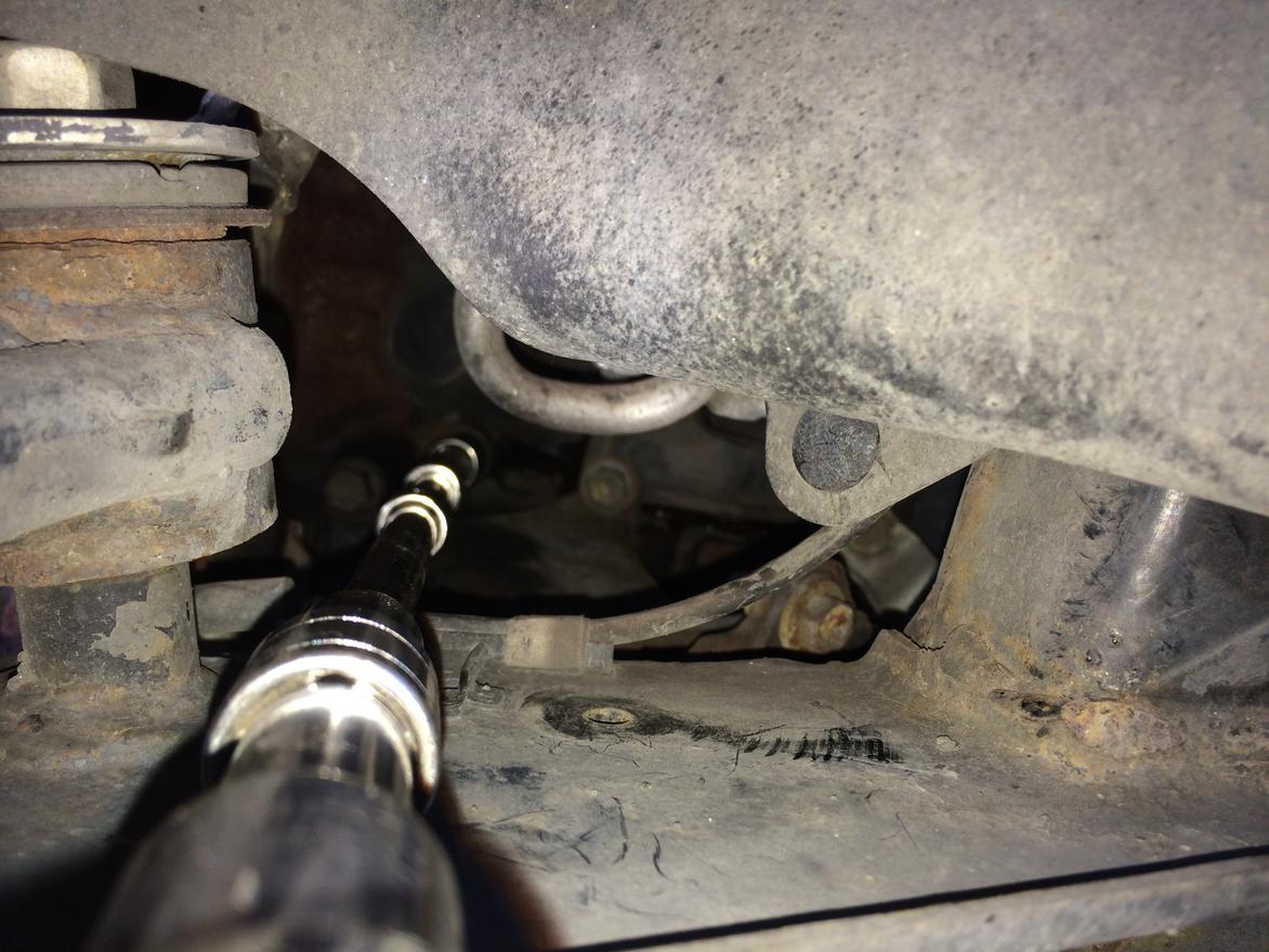

I found the drain plug on my '96 the other day. It didn't have the tube, so it was a little messy, but I was able to access it through the passenger wheel well, after pulling back the flap. It's right behind the freeze plug. I had to use a series of ratchet extensions to reach it.
Image should be rotated 90* clockwise

Also [MENTION=138025]AgeOfOctane[/MENTION], I never had to go through the fender to reach the bolt. For me, just one extension and the socket was all I needed to reach it from the top of the engine.
