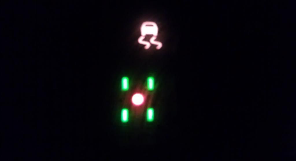

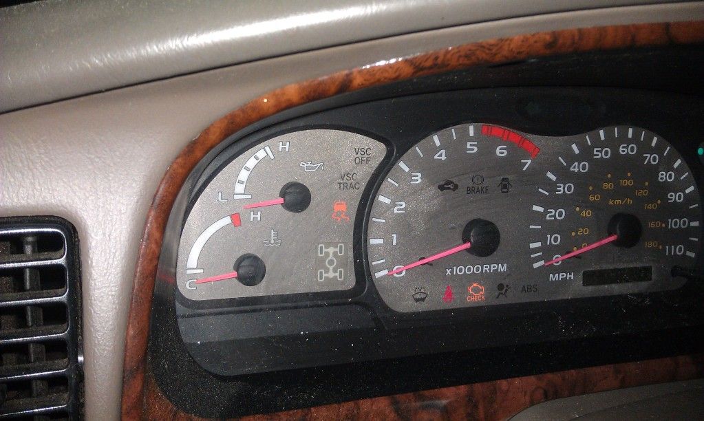

I changed my Instrument cluster with a Sequoia and lost the RR DIFF light. So I wired it up to skid mark light.
