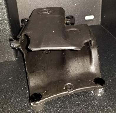

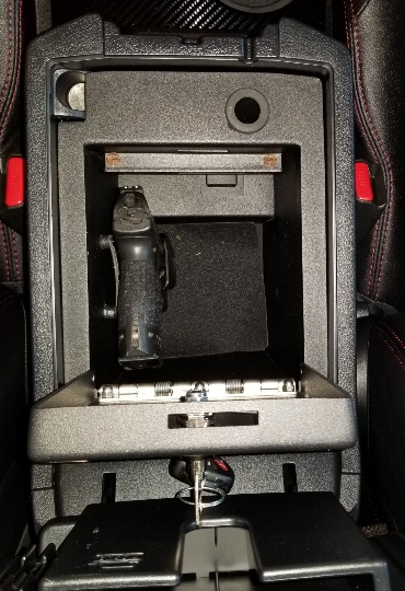

Got it installed. Weighs a bit over 11lbs, drilled out a spot to run a cord for the cigarette power... sorry. The 12v power. One thing I dislike is you can't remove the key with the lock open. So it needs to be locked with the armrest down. Guess I will just put the key on a quick disconnect from the rest of my keys. I was going to make a holster to install, but found an old fobus that I rebuilt. It will hold all my pistols (no retention) with exception to ones with laser/lights. Just wanted something to hold my carry while being protected by a no gun sign.
