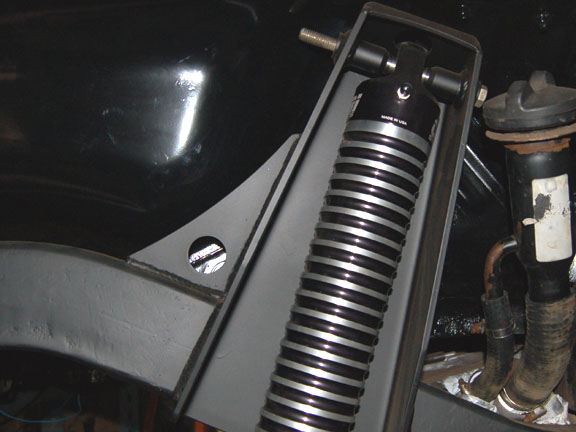

I was looking at something like this

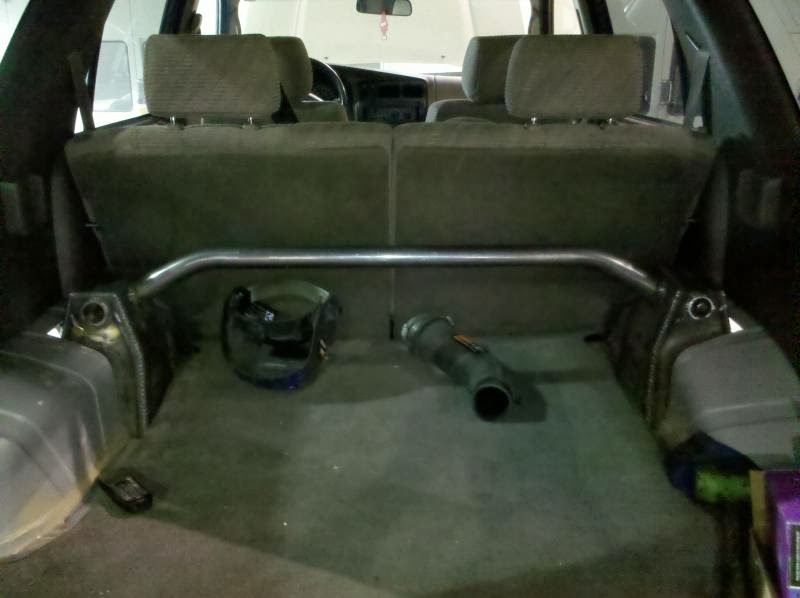

This also figure instead of the bar just brace it in the wheel wells and cap over the towers.

are you referring to the mounting method or the air shock? I didn't think of that. Any thoughts on air shocks in the rear? they would be a bit more compact than coilovers. but I'm guessing they're pretty pricey?
Both. It's what I planned on running on my runner, ori struts and french shock towers. I have the clearance if I measured right to do it now with my stock rear axle 1.25 wheel spacers and stock offset wheels.
