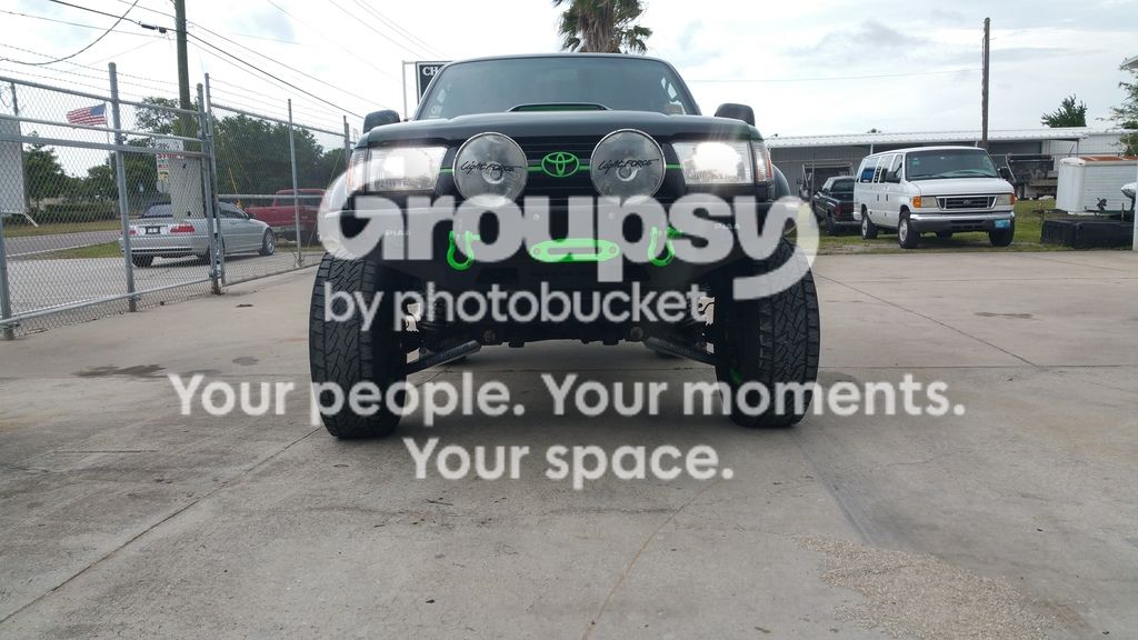

well I live in Florida were there is neither, just mudding! with is fun once in a wile but I just stumbled upon a crazy deal for this whole set up! I just love the look of the lt set ups and the best part is that nobody around here know what the heck it is but they love it!

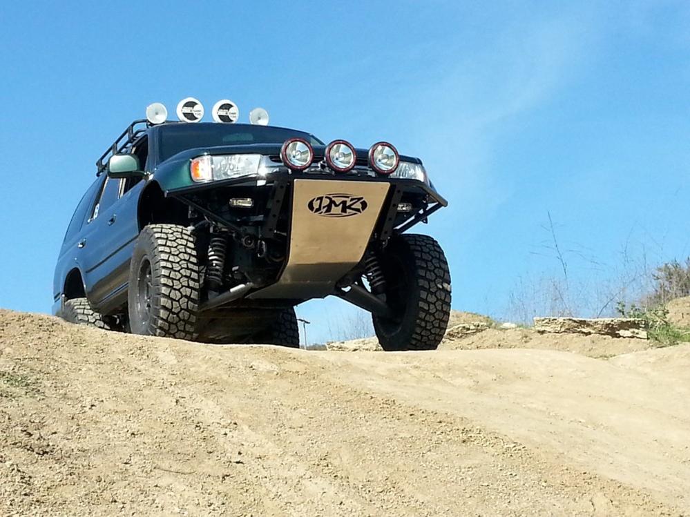

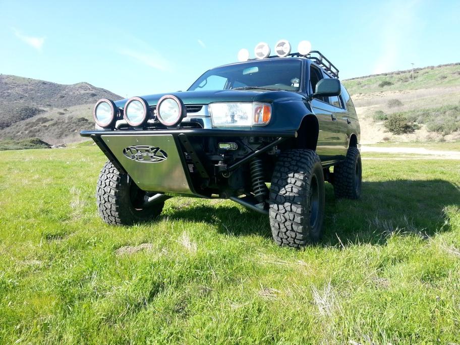

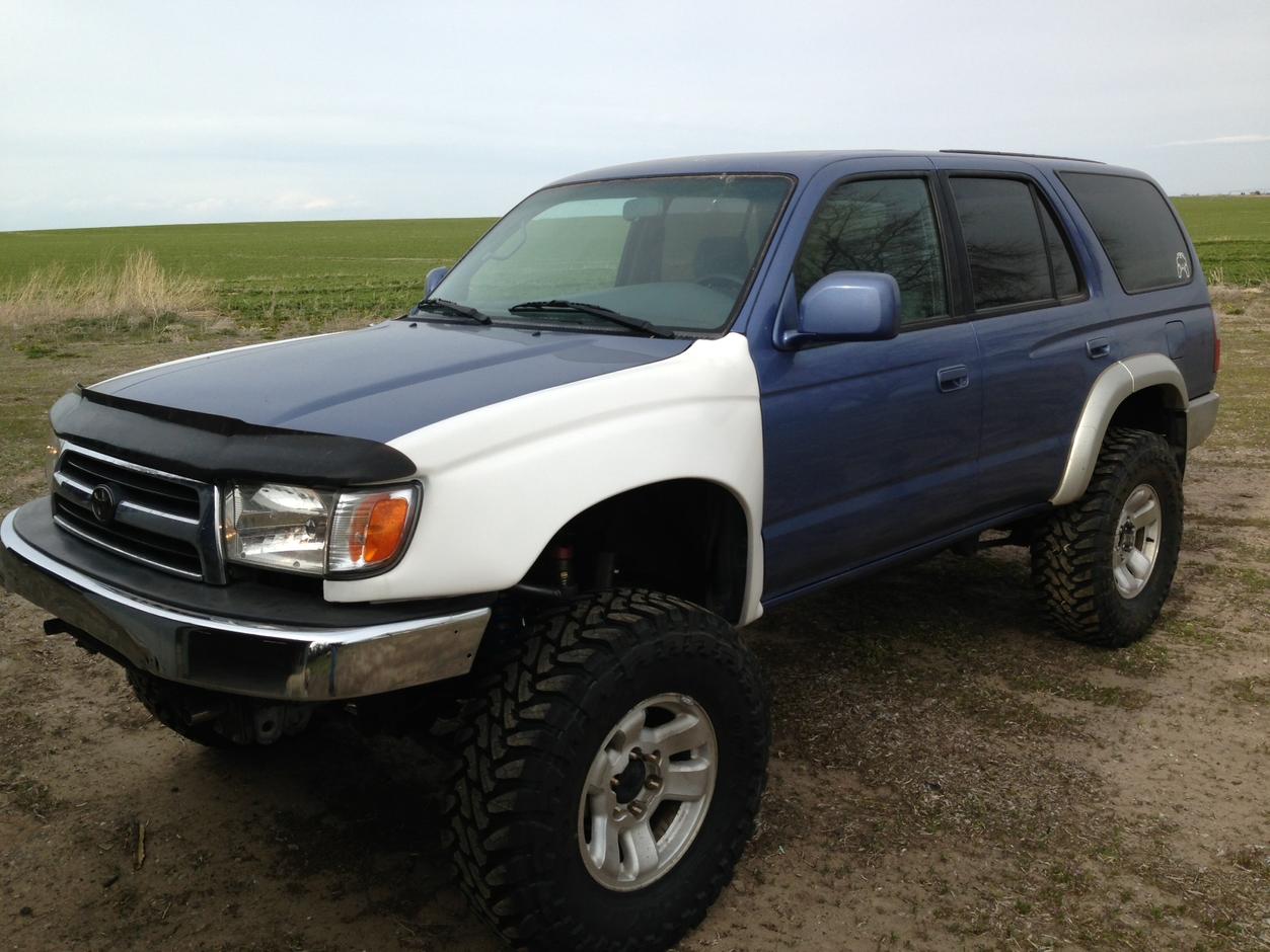

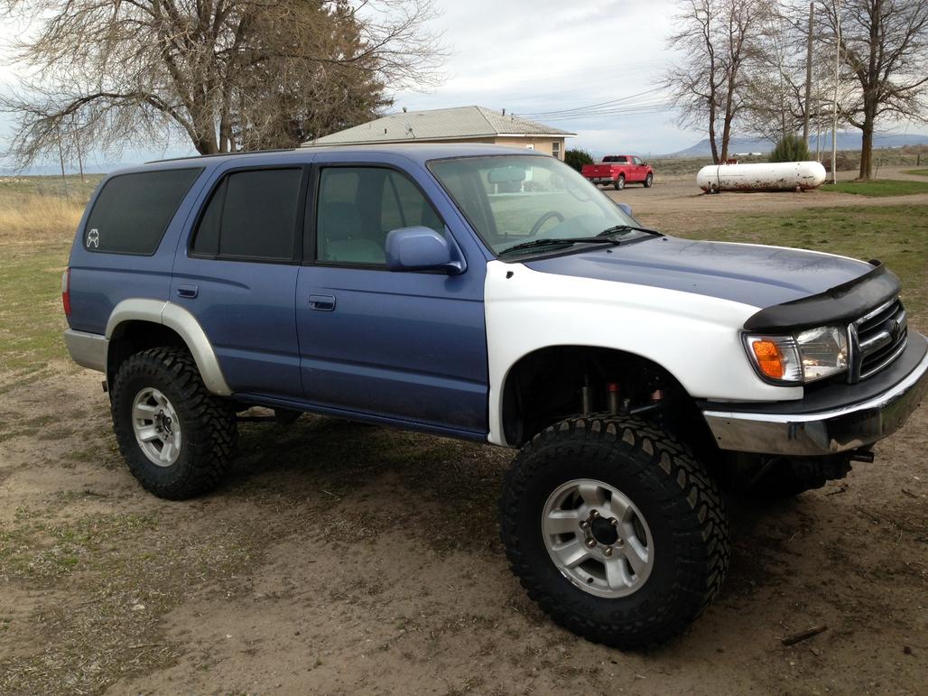

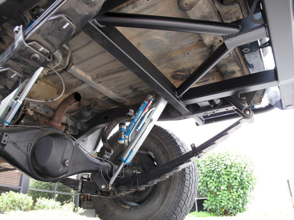

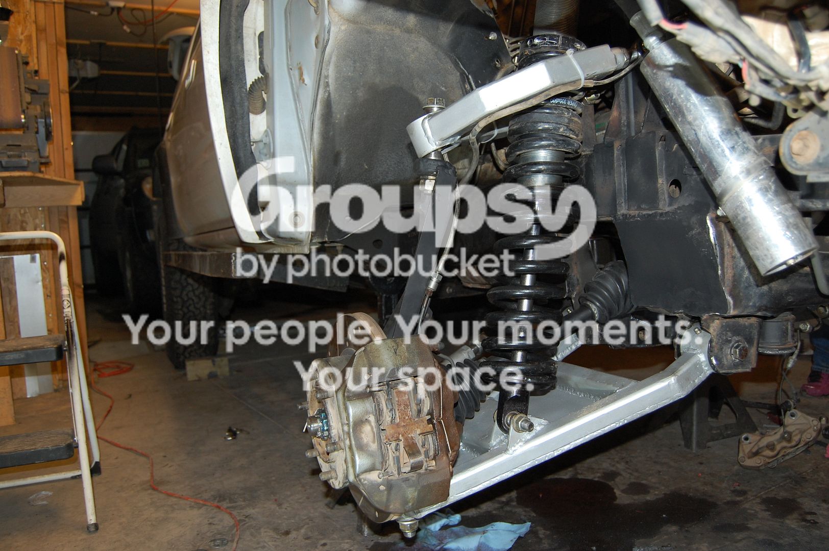

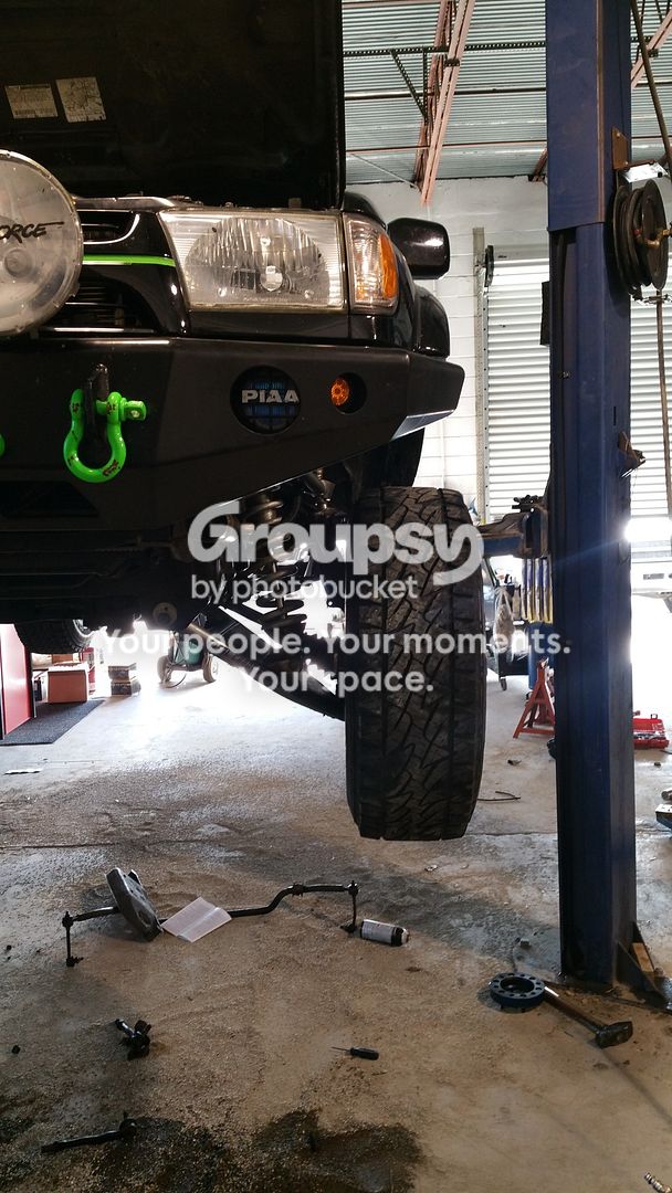

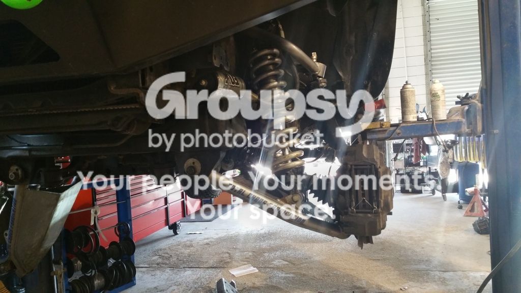

Front end is a custom setup I engineered and built. 10" coilovers, uniball LCA, uniball/heimed UCA, pulling 14" of travel but should be able to pull around 16" (with 4WD). This summer my build will get active again as I triangulate the rear and probably do a cantilever.
df322c8c-4707-44ea-91fb-0092504deeb4_zps5tdvklgm.jpg~original
DSC_4284_zpsdd45898e.jpg~original

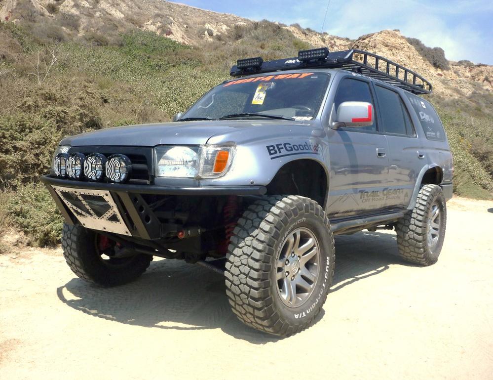

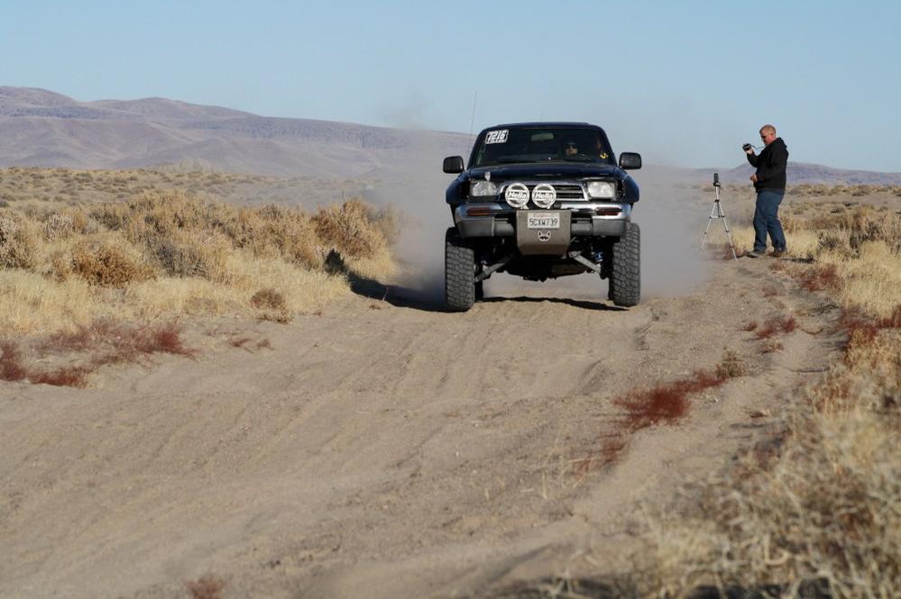

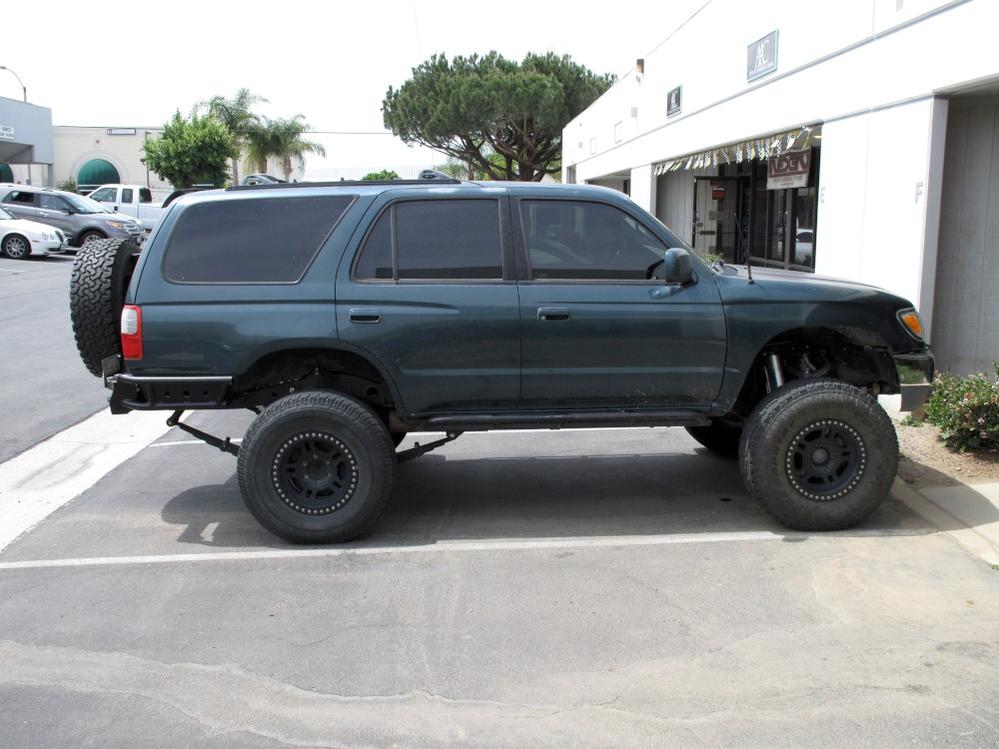

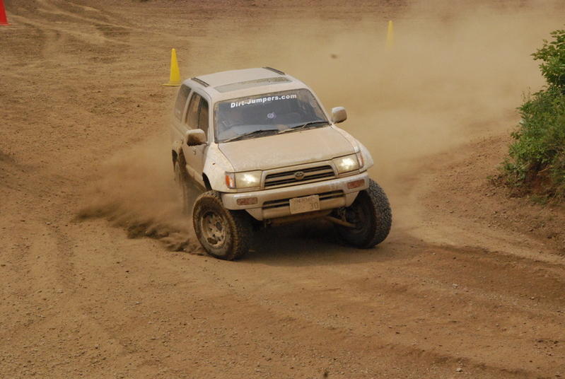

LT 3rd Gen 4runners
Here are some pics that I have collected over the years.
