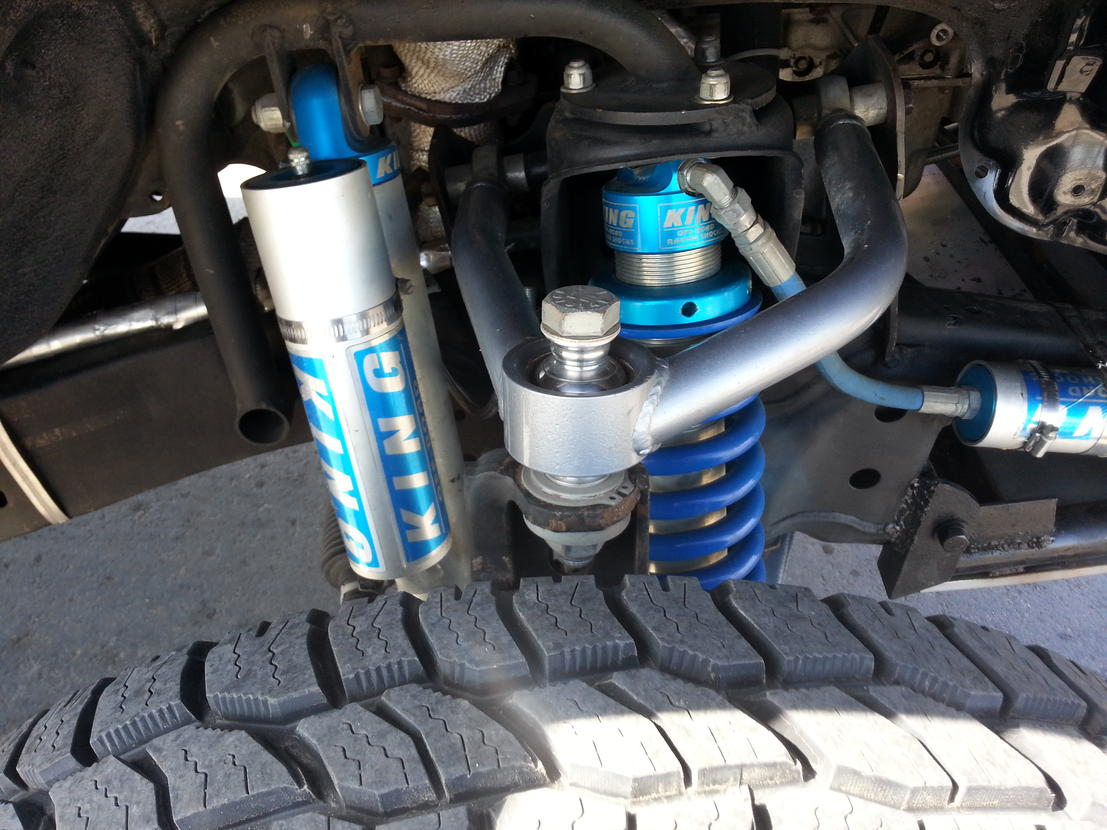

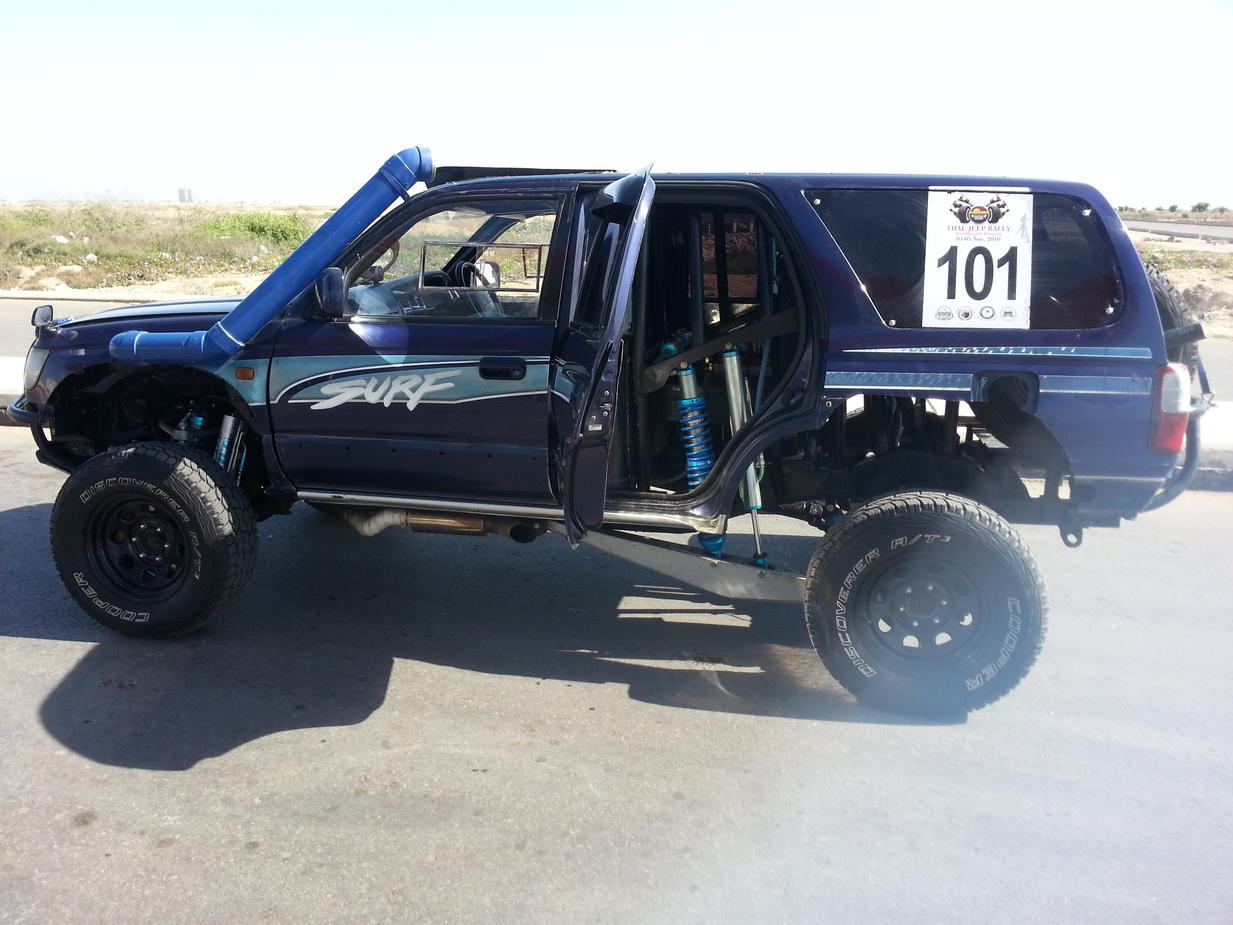

Long-travel Hilux Surf (basically the same thing as our 3rd Gen 4runner):

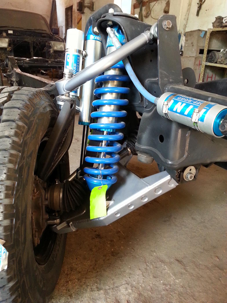

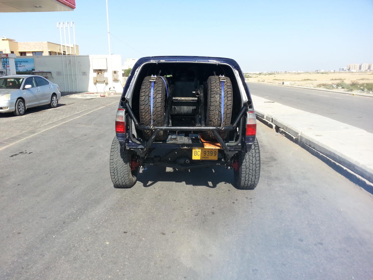

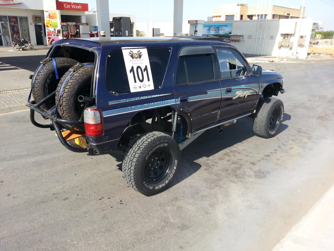

Linked and tied into a cab cage, bypass & c/o's on all 4 corners, side exit exhaust, a home made snorkel and a rear end that's got the biggest truss on it I've ever seen on a stock Toyota axle. On a Hilux Surf with the fender mirror to boot! Where did you find this thing?
