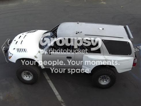

Craziest long travel runner i've seen
Top.jpg~original
Don't think 3.5 would be that bad for some reason it looks like people are running about 4.5-5" wider each side. Could always compinsate with backspacing also.
