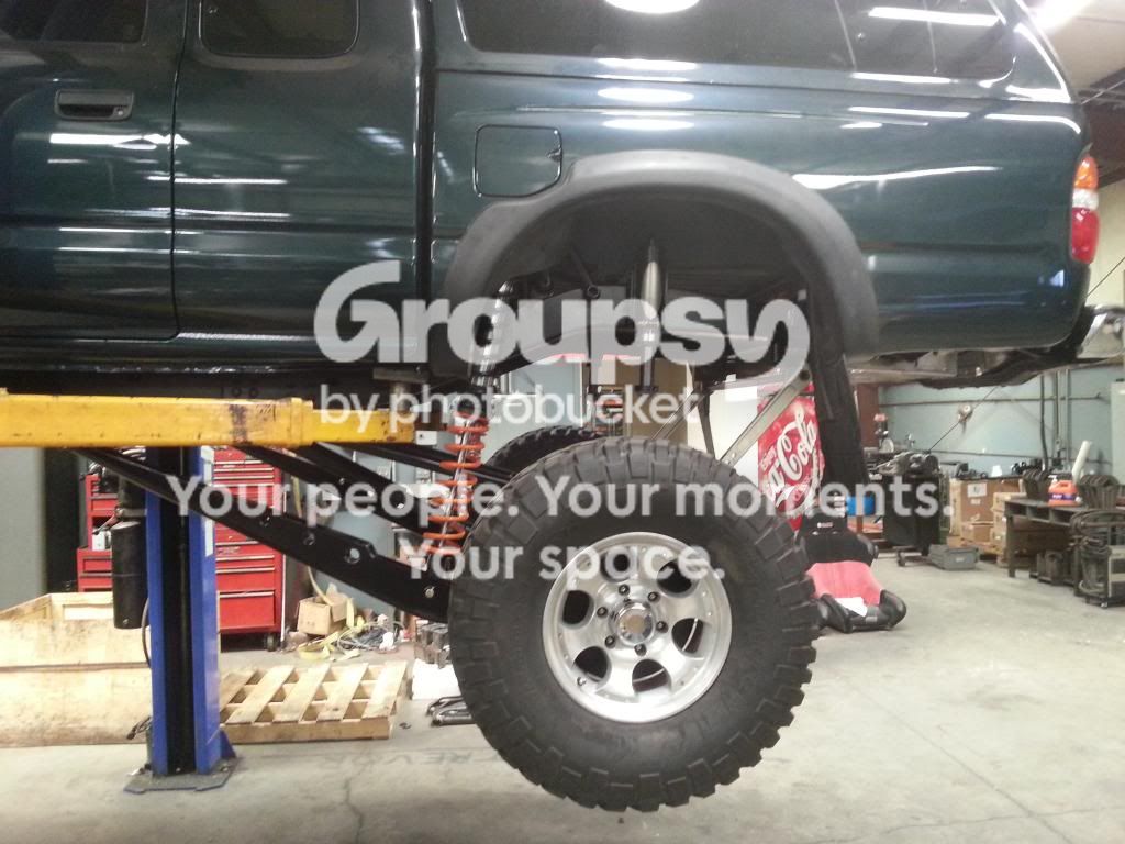

I also see people build these swing arm setups which look similar to the stuff you would see on a trophy truck. This seems like an insane amount of fabrication work too. (Picture below)
I really have no idea the right way to go about this. If I had to cut into the cab, I would hate having to combat all the dust and sand inside. I use my rig for a lot more than just desert prerunning and its setup more as a ExPo / Overland rig than a go-fast truck.
I might have to save this type of work for a Tacoma instead of a 4Runner.
Edit: For some reason I thought that picture was a 4Runner but its actually a Tacoma. Ill keep it up anyways as a visual example of what I was referring to.

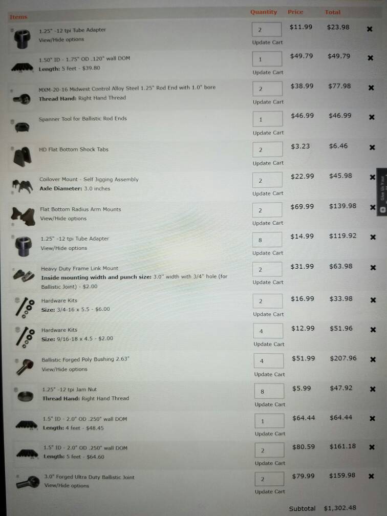

ok, first thing i noticed, they ditched the upper trailing arms and made a big, strong lower trailing arm with the upper connecting into the lower arm. get it? read, "radius arm". nothing wrong with that, it's what i've been planning for my sas, but you can build them cheap! so, really you are buying the cantilever arm itself since that is the only part that takes some scientific thinking on geometry and spring rates. you can buy just the cantilever parts for 2500, then make your own radius arms with stock location. you can buy their trailing arm setup (ahem,radius arm) for 1200. you can also add in everything for the full kit.

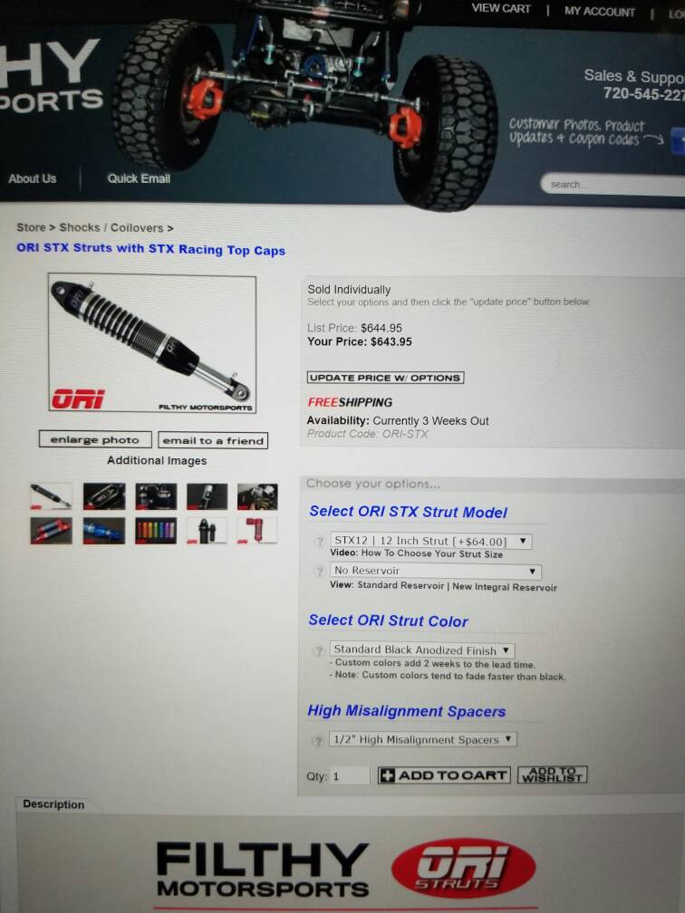

now, here's the thing. several have sas'ed there trucks. crozhawk for example has 14" shocks on the rear of his truck with a 3 link. his travel numbers are insane! no cutting into body btw. for myself i plan on making long radius arms, approximately 50-60" long. then i will have to measure but plan on running 14-16"travel ori struts. no needed bumpstops, limit straps, or sway bars as they are all built in, smaller package without all that extra stuff, cheaper than buying all those too. no hassle of figuring out the best spring rate because you adjust with nitrogen pressure. they also don't unload which keeps you stable. one disadvantage, if you blow one you have nothing on that corner holding the weight up. there have not been instances of this happening outside of full racing with extreme loads. either way, you could build a setup with the same or greater travel numbers for cheaper.
Here's my idea for the rear. Ballistic is the main site:
Then filthy Motorsports for 14" travel ori struts:
Should allow for some nice travel numbers!
