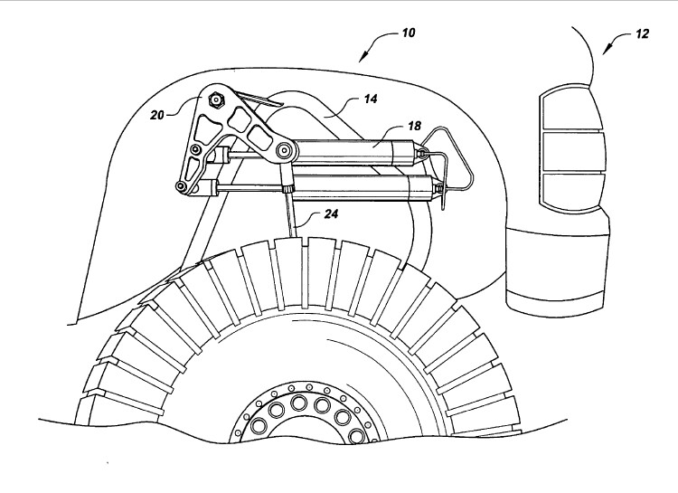

I've often wondered why we don't see many horizontal shock or coilover designs in long travel setups. Although I haven't researched it in any great detail, it seems like a good option for vehicles with limited vertical space for extended towers.

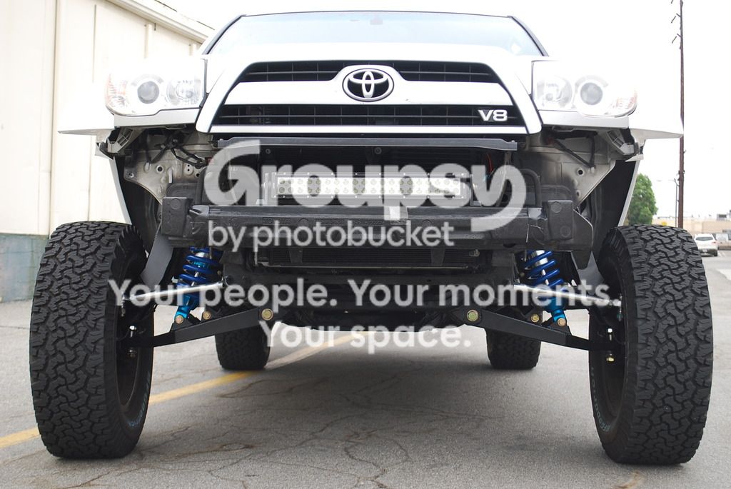

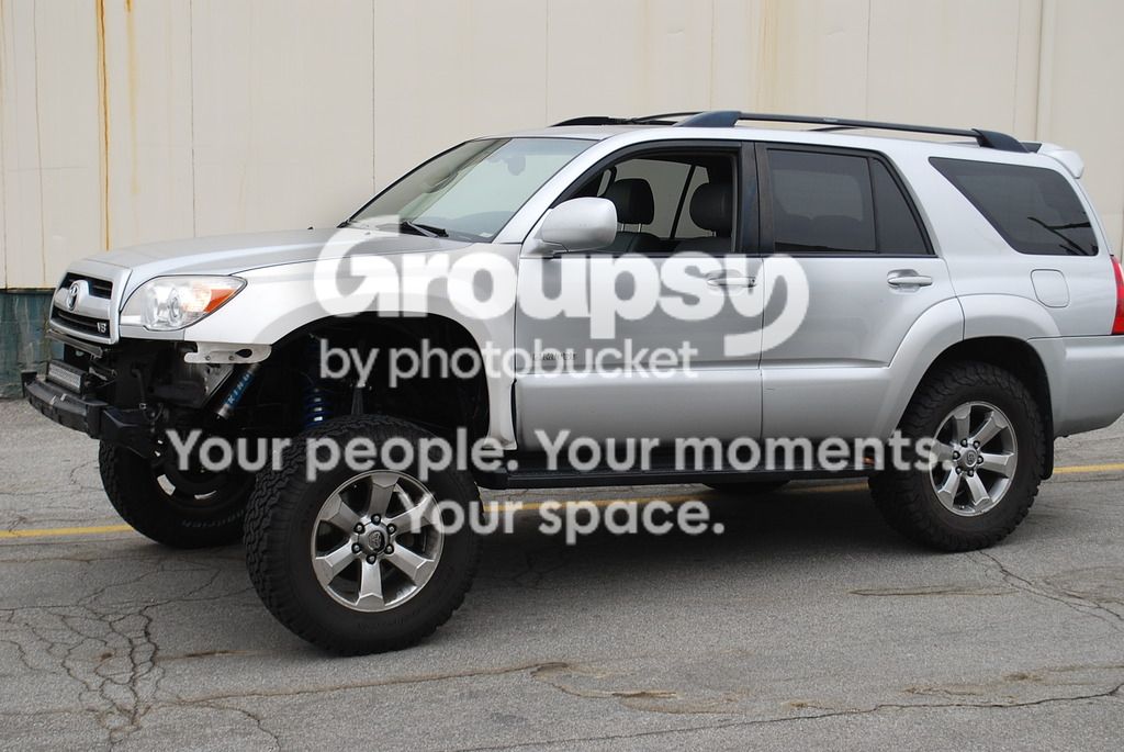

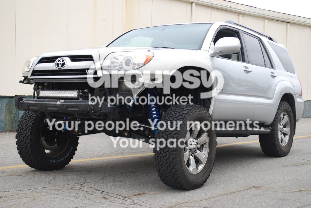

I basically just took a stock arm, cut it in half, and carefully measured the amount I wanted to extend it, and welded a tube in there to make an arm the right width I needed. Then I took that arm, and built a jig to hold the bushings and balljoint in the right place. Then took plate and filled in the jig, using new bushings and the cut off ball joint holder (dont know what its called) from a stock arm.
Then for the uppers, the same principal applies, but I moved the upper uniball over about an inch (I had to do trial and error, with cycling the the suspension and measuring the caster with an angle finder on the spindle) until I got around 6º of caster. I also used heims on the uppers, in order to allow enough adjustment to fix any error I made and adjust the caster and camber. Doing so I was able to get the alignment perfect side to side, with about 5-6º of caster.

Well I'm thinking right because that's literally word for word of my personal thoughts. Once making a jig you could also buy heavy duty tubing and make your own arms out of that kind of like allpro did, and then gusset with 1/4" steel to reinforce. I would also put a plate along the bottom of the arms for a "slider" affect, which would further strengthen.
Do we need 5-6* castor to move the tires forward and correct alignment and steering? I have been thinking of when I fix my inner and outer tie rods that I should adjust my uppers for more caster. I have like 3-3.5* right now with 4" of lift.

Yeah not many other ways to do it really haha. But tube would work too, as long as there is some plate to reinforce it. As for the castor, it helps to have a higher number, at least for offroading. It also helps tire clearance at the rear of the fenderwell. If you want to maximize caster and clearance, you could even push the lower ball joint forward a bit, although go too far and the axle will most likely bind.
I was thinking if I could push them forward an inch without issue that would be nice. I have all the room in the world in front of the tires, especially if I relocated the washer tank. When I do my tie rod ends I'm going to bump my caster up to 4-5* and see how that treats me.
Sounds like a plan. The increased caster is really nice, ideally Id have mine about 8º, but at that point, tire wear is accelerated too much for street driving. Also remembered this thread How to make sweet Long Travel Suspension | Toyota Truck Forum | ToyotaTruckClub.com
Basically has some nice pictures to follow along with, and is exactly how I built my kit. But instead of using a stock total chaos arm for the jig, I used the cut and extended stock arm.
