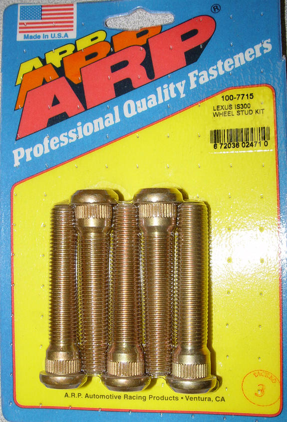

I'm running ARP studs for Lexus at all 4 corners. Dont buy Dorman or any other aftermarket crap if you're going to be wheelin'. Toyota or ARP only.
Amazon.com: ARP 1007715 Wheel Stud Kit for Lexus: Automotive
I should have added in this first post, I know about the ARP studs but they are way overkill and far to expansive for this application.

A daily driver? Even more reason to add quality parts. When you're spending a lot of money on wheels & tires what's another $130 for peace of mind? The ARP studs will outlast the truck. I did this research 2 years ago. There's very few options.

As per ARP's website,the IS300 studs have a UHL (Under Head Length) of 2.6" with .23" of knurling.

I used the dorman Toyota matrix studs, the pricetag on the arps is absurd, especially when the Camaro studs I bought for my rx7 which are close to identical were only like 15$ for 5.
