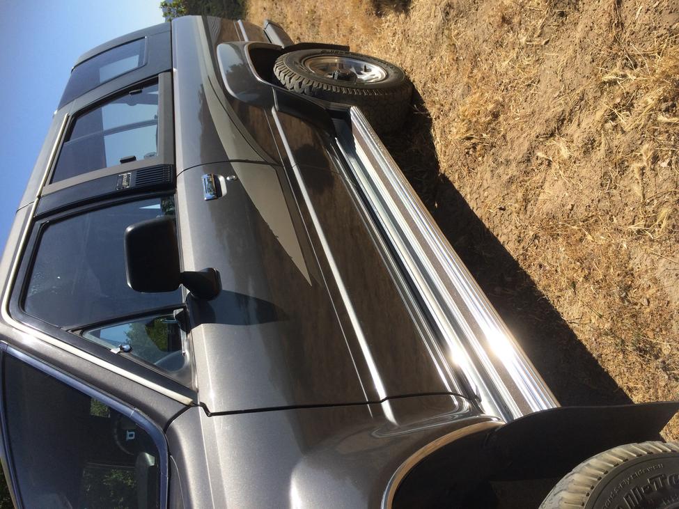

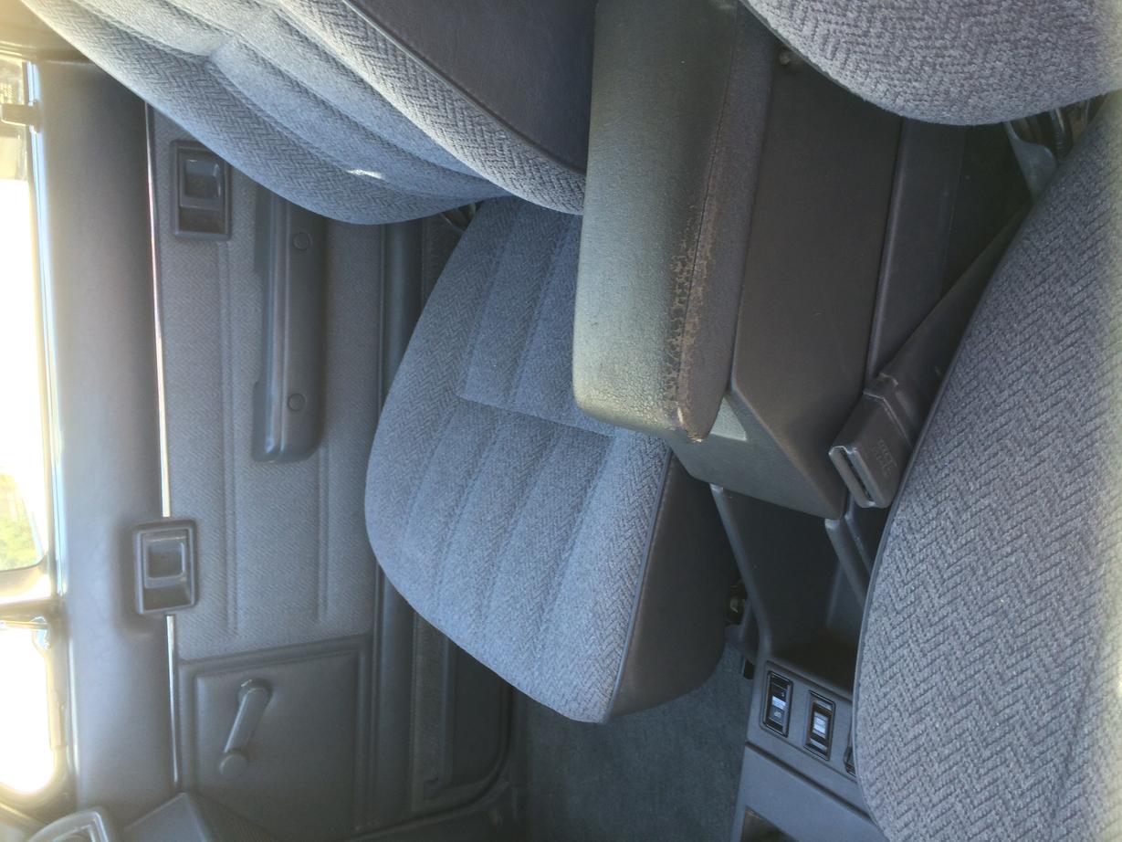

I love these old 4runners because they are freaking sweet first of all. I had a jeep and I loved to take the top off but not enough room. This 4runner would solve all of life's problems haha. I'm selling my 08 xterra because I know it will loose a quarter of its value in two years easy. These old 4runner value have been steady if not on the rise for sure. I don't want to loose my money when these tr4 are way cooler and do the same thing. Here is one in looking at. I think I would like the v6 because it would have more power and wouldn't be so slow. Is that a problem with the 22. I don't do any towing so nothing to worry about there. Also I know they are rare and it'll be hard to find ones in mint condition. So I wonder about the head gasket problem with the v6. Here is one I'm looking at. Tell me what you think. I think the price is to high but I can try I haggle a bit. 1989 Toyota 4runner he sent me other photos I can't upload them now. But I see no rust no dings interior is so clean like new. But is it worth it to wait for a 22 because those are more sought after an value will stay high?

I guess it worked. Also I'm in west LA area. So if I find one that clean in San Diego I'll drive on down there and get one.
That one looks clean. Before you decide on 3.0 or 22R-E, I suggest you read up on people's experiences. Check Out Redeth's on yotatech. He has a 3.0. When I looked at the engine compartment I was intimidated by how tight it is.
On my 22RE, occasionally, I'd just lie down underneath and see almost everything, leaks worn out parts or wiring insulation, if any...
I'd say don't do it!! I live very close to you and the 1st gens around here are worth waitin for. We don't get the rust that some other states have to deal with and the 22re is worth the wait. One will pop up. I check c list often and I've seen a few tht I wish I had.
