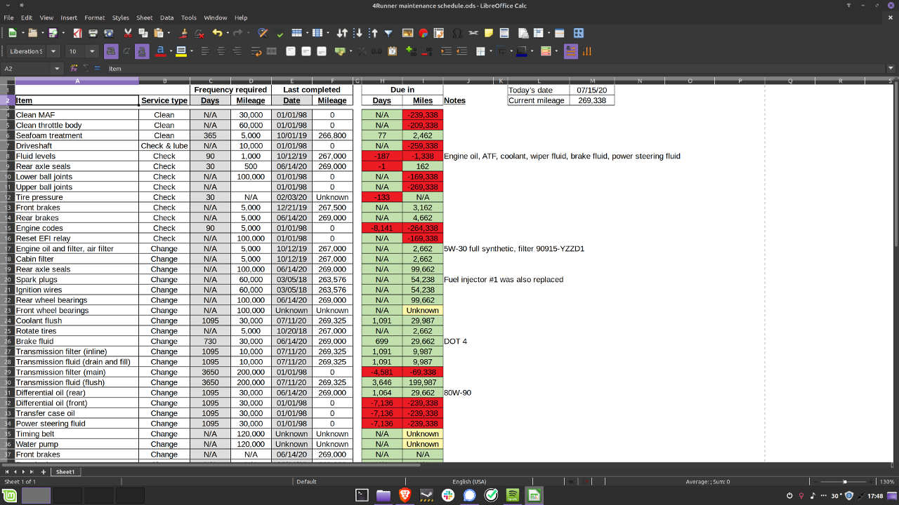

I was looking for the same thing recently and started putting together the information as I found it. Then I decided to get serious and apply my spreadsheet skills to create a worksheet that would automatically track everything for me.
From left to right, the columns are service title, service type, recommended time (in days) frequency of service, recommended mileage frequency of service, last known completed date, last known completed mileage, due date (in days) of next service, due mileage of next service, and notes.
The "Due" columns are color-coded by percentage of time or mileage until the next due date. They go through green (rest easy), yellow (start planning for it), orange (schedule it now), and then red (overdue).
The previous owner had quite a few maintenance records, so I've been exhaustively going through them and entering the information I have. You'll see that there is a lot of red on mine, that's where there were no records and it's something I plan on doing in the future.
I'm still working on it, but if there's an interest level I could send it out to interested parties once I'm done.

Just to add to yours:
Coolant should also be time based, 2 years if it's the OE Toyota Red.
Brake/clutch fluid should also be time based, max every 3 years.
Power steering, fuel filter every 50,000 kms
Every 2 years I also like to check the spare tire pressure. Most people forget about this one.
