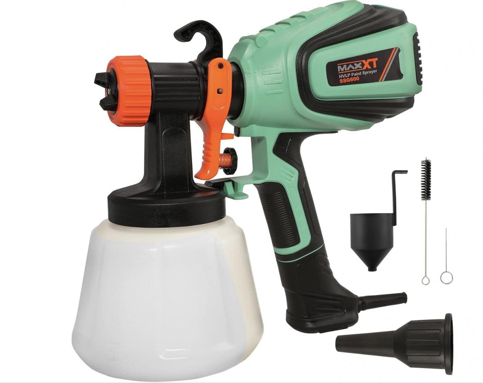

Old thread. I bought a gallon of Blaster surface sheild. Stuf is crap. After spraying on the underside of my 4runner it dripped continuously for months and one year later the rust is completely dry and active again. I had used NHOU and really liked the results. It never dripped and coats well.
I bought this $25 air sprayer from ebay and it did really well. Best to do it outside and wear a mask. There is no moving parts to fail so it should last years. And it had no problems spraying the thick NHOU fluid using the biggest orifice 3mm. Buy it by the gallon, its more economical.
MAXXT paint sprayer

I bought this paint sprayer (used) and it struggles with fluid film - gets gummed up several times during use
Try drilling out the orifice to let more product out. Mine is 3mm. And seems to work well. I also found that running it up on ramps helped get a good angle at the frame. Did ramps on each side to tip the truck away.
