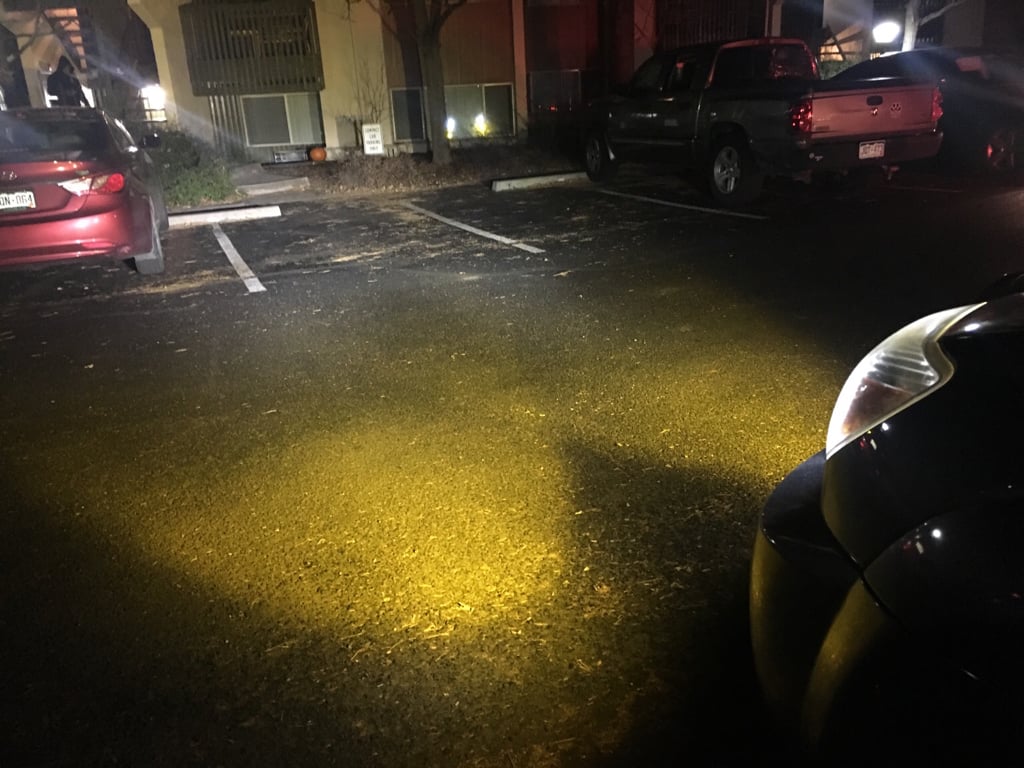

So, i switched out my factory fogs for some Rigid Industries D2's, and also put in a light bar in my lower grill. i can tell when my fogs are on now, and they help..its not a night and day difference, but the yellow beam is definitely visible. i will take a pic when its dark outside so u can see.

** forgot to mention, the rigid fogs are actually white, but i bought the rigid "amber" (yellow) covers for them. bought the fogs and covers off amazon.

For me I can say I like 3000k , yellow, or amber lights in rain and fog condition. That also includes think desert white-out conditions. To my eyes they help a lot.
In the rain the higher color temp LED and HID lights really seems to get lost on wet ground... I just get less of that effect with a warmer color in general.
I think placement and beam pattern also make a really big difference in the end result... as I have learned from recent lighting projects on my rig.
Having a lot of light is great, but controlling it is just as important... some of my best viewing experiences has come from lights mounted low, and that have a good bit of throw.

You want to get light on the road, but not on the snow falling in front of you. The best way to do that is lights with a sharp cutoff. If you haven't upgraded to the 05+ projector beam headlights yet, that will help a lot. Even then you will still have trouble seeing in the heaviest falling snow.
I think the 03-04 fog lights are projectors, so that should help get most of their light onto the road. The newer fog lights are reflectors, and they send a bit too much light up in the air.
It would help to do the anytime fog light mod so you can run fog lights and parking lights without the low beams. Make sure to use the parking lights not just the DRLs (if you have DRLs) so your tail lights are on so you don't get rear-ended.
A light bar or extra fog lights could work as long as they have a sharp cutoff and are mounted low.
If you're driving in conditions that form rime ice, make sure it's not building up on the lenses of your lights. That will blur the beam and send more light into the air to reflect off the snow. The projector low beams usually burn through ice, but a couple years ago I was driving in snow so bad that the entire front of my car including the lights was covered in 1/4 inch or more of ice by the time I found a safe place to pull over. I could barely keep the windshield clear despite blasting the heat to try to melt the accumulated ice and snow.
