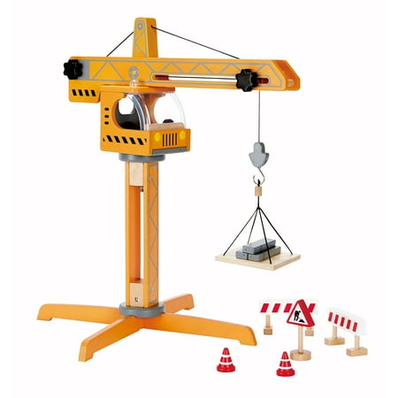

i want to change it to 2 pieces. a base and one single vertical post connected to a horizontal post. this way i can take the two pieces out in to my driveway to put together and i can store inside my garage easier. my new design idea is to do something like a mailbox post/street light post. what i don't know is, how big does the base need to be to support the weight of the post and tent. tent is around 170lbs, electric hoist is around 20lbs and the lumber parts are easily 50lbs
right now the electric hoist is 4' in the center of the 8' horizontal 4x4. i am using joist hangers instead of resting it on top of vertical post. do i cut the 8' long down to 4' or do i need to move it on top of the post and have some hang off of one side of the up beam for counter balance? do i then add a 2-3' long angled bracket from up to cross beam for more added support.

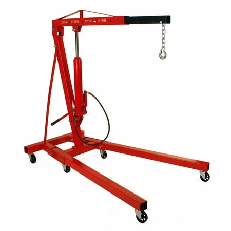

for the base my hope is i can use the two existing feet and make a base out of those in a + shape. using 2 2x6's 4' in length with something like a concrete block in the middle and the same angled 2x4's. or do i do it more like a cherry picker with two V shaped feet.

crain idea
cherry picker idea

I assume you dont have the garage overhead to mount the winch up there? There is a reason they make crate hoists and cranes from steel, not wood. I dont think you would get the lasting success you are looking for by using the existing wood feet for a one-sided approach. Large cranes generally incorporate a counterbalance and pulleys, or can be fixed to a floor. Depending on your length & load rating, you might be able to rig up some pulleys to relocate the unit and save some overhead weight. However, your existing legs are not long engough for the hoist approach either, even with concrete and sand.. (& that would be a PITA to haul out..) Hanging ~200 lbs 8' off the ground & out 4' (or more..) is nothing to take lightly dangling over your ride. plus, it would require you to swing it over from the side rather than backing up unless you made it even longer or included a swing arm. I would look at using something like 8020 if you want to beef it up.

To go to a single post, you will need to anchor it into the ground or add weight to its base, which doesn't make it portable unless you add wheels like luggage. Or, you could make the base flat enough that you can drive over it and rest your rear tire on it while you lift up your tent and swing it around the other side on top of your vehicle.
The less length you need on your upper arm the better so you will want to keep the vertical post as close to your vehicle as you can when loading/unloading.

[MENTION=130999]Inv4drZm[/MENTION] critique away please! i tried a pulley system, a 4 pulley setup, it was too difficult. this hoist pulls the tent up with ease and locks when not in motion. it is a lot easier to lift up/down to get it in place with the tent mounts. i wondered about using the car weight to keep it down, but i don't have an easy way to make it swing over the car. i would anchor a single post to a wall and use a wide base. it still worries me though tipping over, ruining my tent and car
