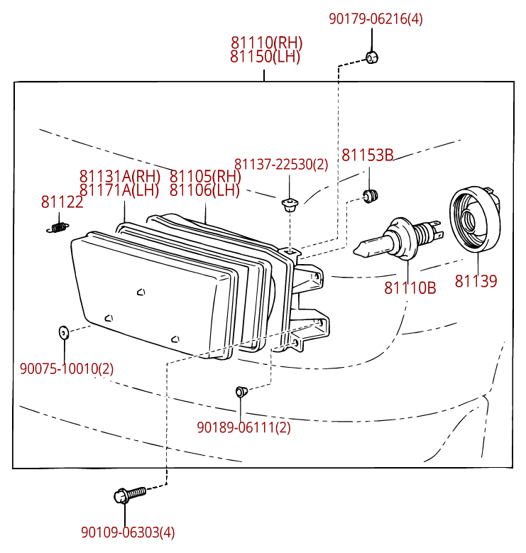

So i went off roading in the desert last weekend and went a bit too hard. My passenger side headlight pivot socket is gone. The actual screw with the ball at the end of it is still there, but the socket it fits into fell out and is nowhere to be found. Does anyone happen to know if I can even get that part by itself? And if so, where can I find the part number for it?

You can buy just the bracket separate This is what I had to do. took the tech 20 minutes to do the part is either 81105 or 81106 depending if it is left or right
bracket retails about 75 bucks plus tax from Toyota
