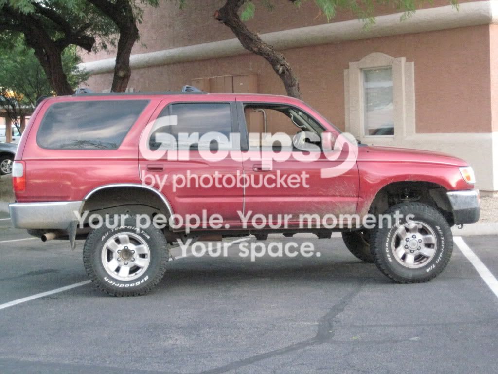

Just finished my S.S. 1.2 lift today.
DAMN that looks huge!!!! :jaw drop: Let us know how it runs.

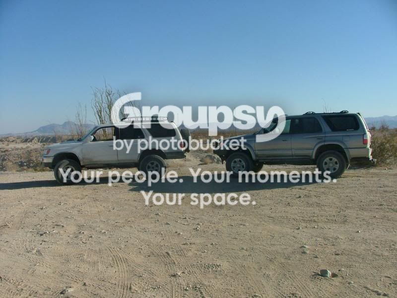

Thanks smallfry for the comparison pic.
037-1.jpg~original
This was a pic from last nite, coils only, no shocks. Put the shocks on today and the rear is a little higher than this picture now. If you would like pics, I could take some tomorrow.
Yeah! If you don't mind, that would be great. How does it feel on the road?
Feels really good. I need to get it aligned tomorrow. My stock suspension was totaly shot as far as shocks were concerned. My springs were in good shape. Rear springs were done on the recall, so they were like new.

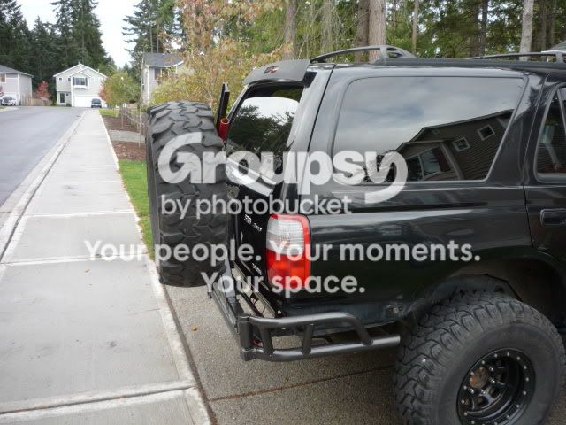

i am running the 1.2. before putting the current bumpers on all i had were the stock fat lip front bumper and a trailer hitch on the rear. i cant find any pics from when i first lifted it ill have to dig deeper for them, also cant seem to find any direct side on pics.
best side shot i could find
054.jpg~original

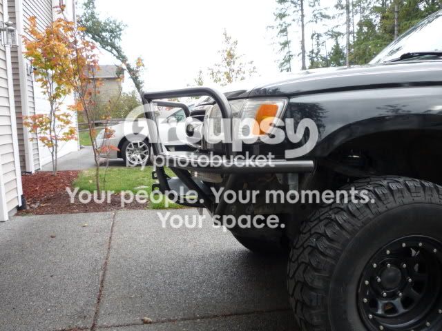

close up of the front
the4runner058.jpg~original

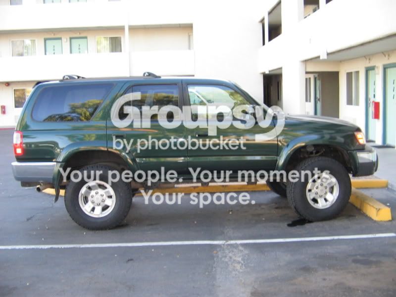

Mine with the 1.2 rear and All-pro Coil-Overs cranked up front and ProudRunners with the Toytec Ultimate lift.
DSCF4379.jpg~original
