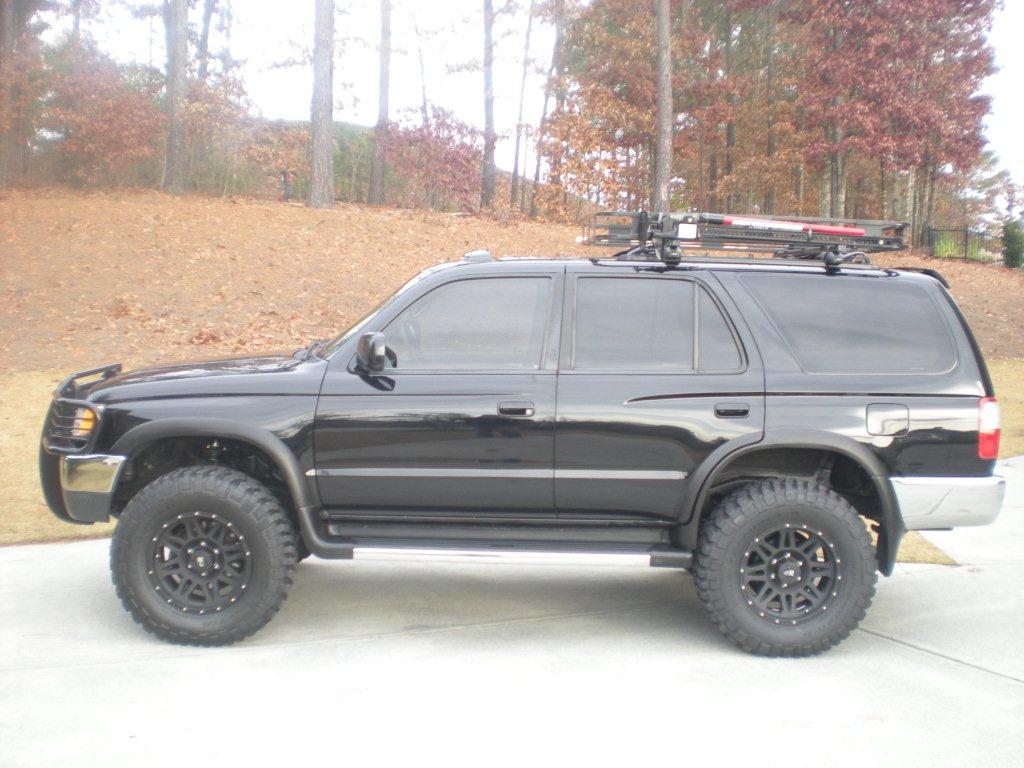

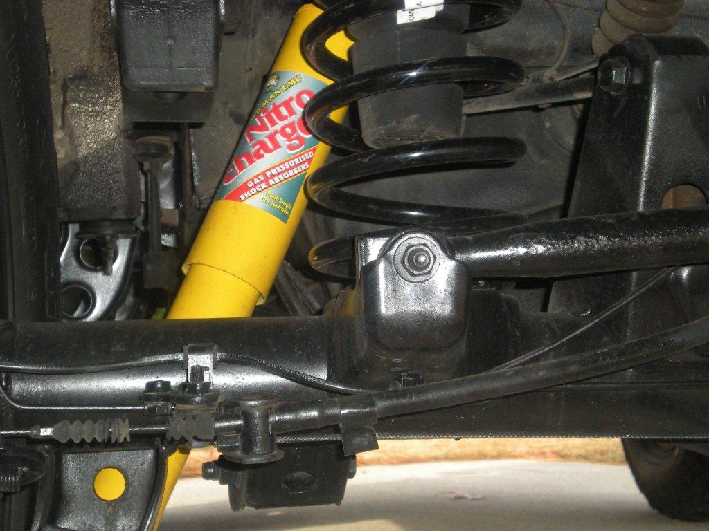

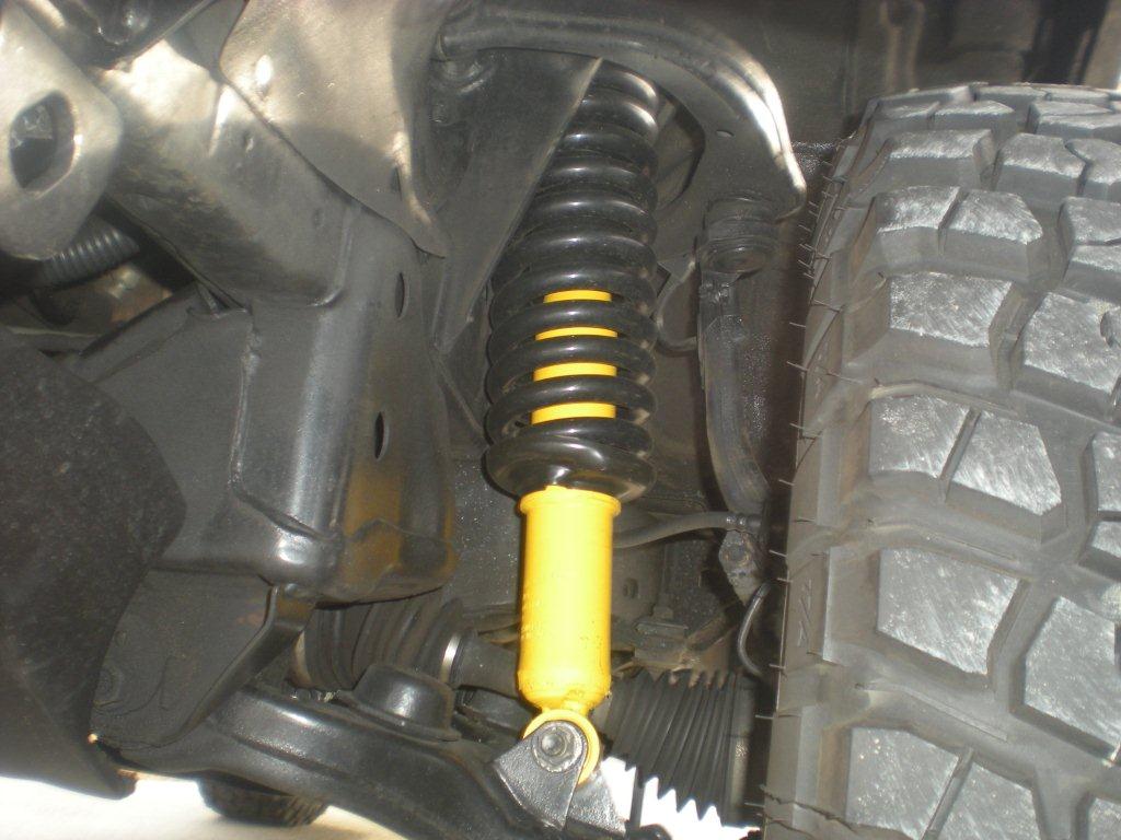

Toy Tech was the best for me. They were out of the ultimate lift, so I went with the OMU. Works perfect nice ride easy to install! Hope this helps
Thanks for the info, Pikeman. This is a little off topic but is there any chance of getting a photo of your 4runner from the back to have a look at your spare tire set up?
jjarr208, thanks for the picks and nice truck BTW. I'm leaning towards the s.s 1.2 lift but I'm still having trouble committing. It's a lot of money but i know that once I bite the bullet I'll be stoked. Tax return should be in the post very soon :banana:
