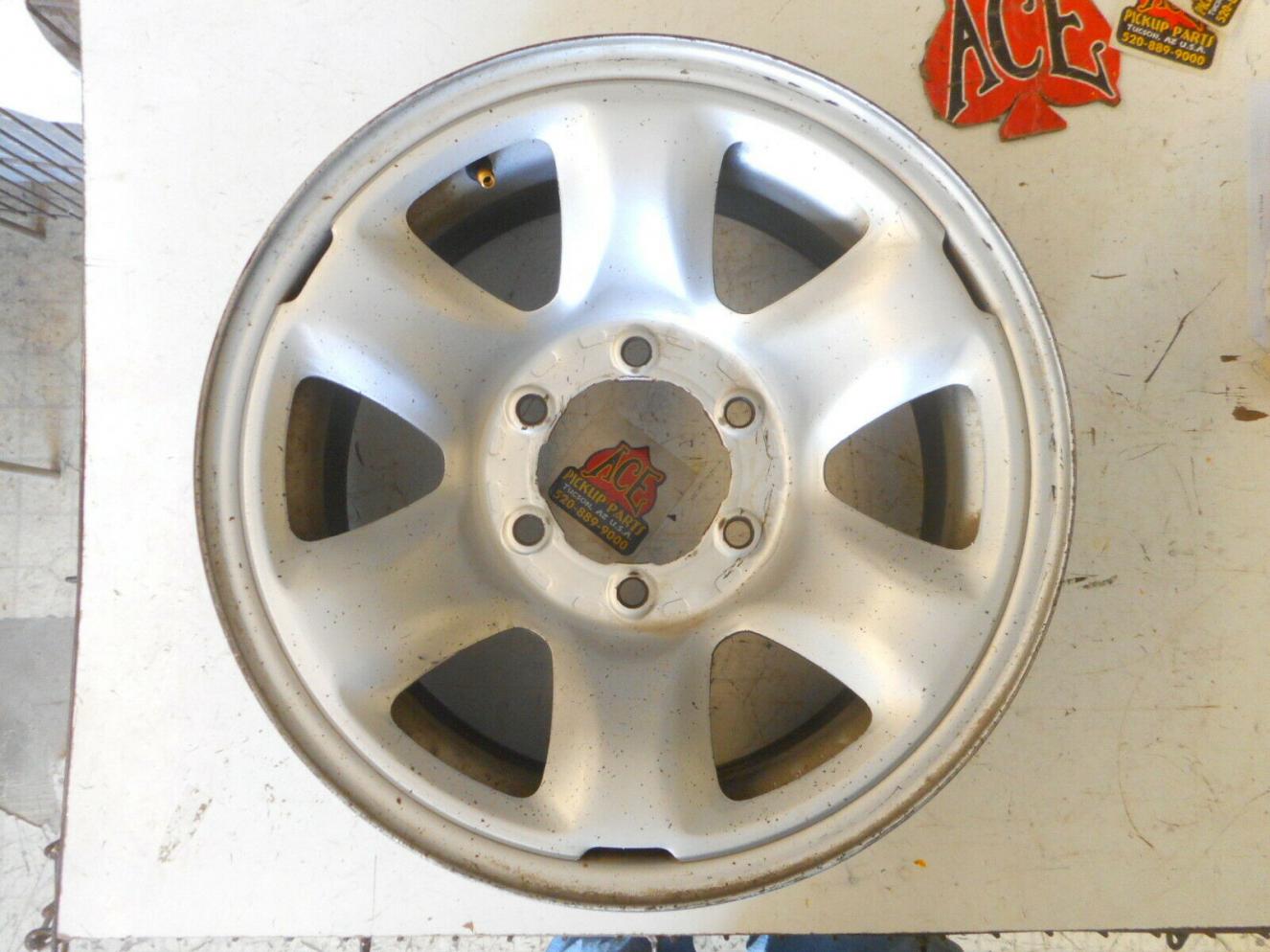

The 69353 is the 16" stock steel wheel, but that image is the 15" wheel, which is a 69355. The 16"ers are easily identified by the three drain slots between the hoop and center section like my photo. (15"ers had no drain slots) The 16"ers are not as common as the 15"ers, but were also on T100s.
If I was looking for a cheap set of wheels that fit Tundra calipers, I'd be looking for first gen Tundra wheels... I have a single one that I use for my spare (16") so I know I can put it on any corner of the truck with 231 calipers on it.
