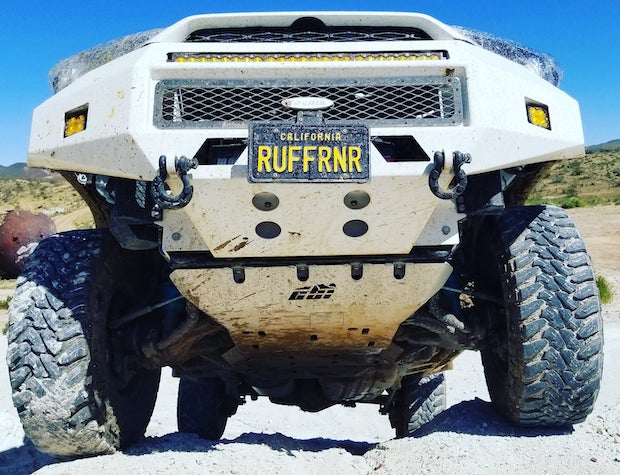

I considered aluminum bumpers, because they are half the weight of steel, but after a lot of looking, I saw people with aluminum having welds crack at stress points, re-welding only to have the crack reappear. I also just felt uneasy about my recovery points being aluminum. Aluminum recovery points should be fine, but when I thought about the forces in play with a kinetic recovery, I decided to go with steel. For my skid plates I did go with the CBI aluminum set up. Expensive but very light and has served me well. It's scraped up and has taken some hits, but is still straight. I also have the Rago sliders, very beefy, but I think they were loosing money making them and are no longer offered on their site. Theres a current thread going right now on weight that might give some insight.
Lets address the "elephant"/ weight in the room!
