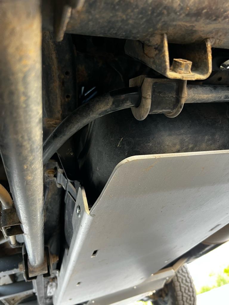

It probably isn’t related, but juuuuuuust in case, I remember shortly after I installed my skid plates I ended up getting a loud pop under articulation while wheeling.
Took me forever to pinpoint it, but while it sounded like coming from the front, the issue was in the rear.
Somehow I was missing the bolt for the bracket holding the rear sway bar down to the rear axle. So under articulation the rear sway bar was hitting my rear diff skid.
It didn’t happen before because without the rear diff skid, there was just enough clearance for the sway bar to miss the rear diff.
