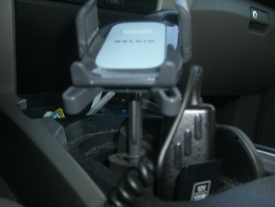

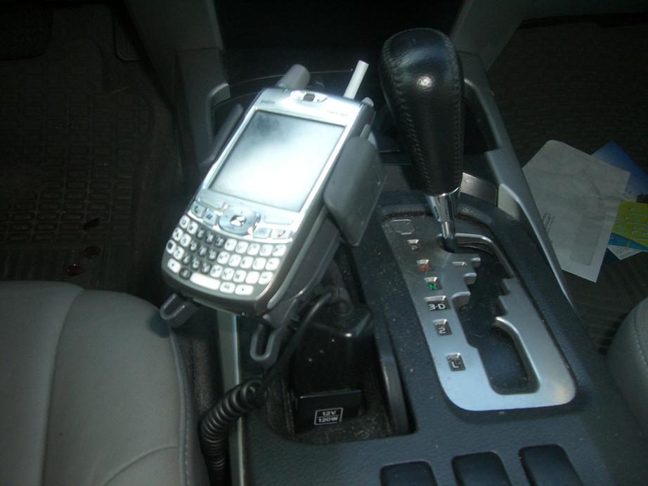

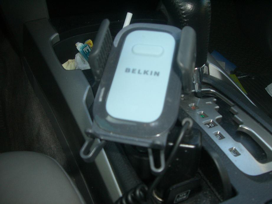

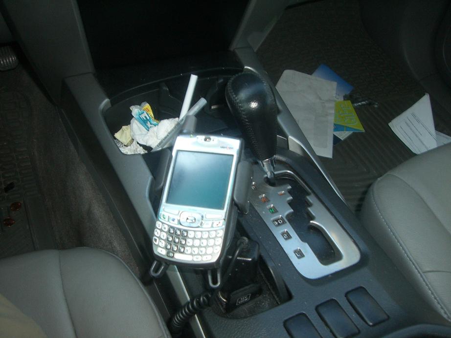

I just bought the Belkin car cup-holder adapter for pocket pcs/smart phones, then I cut off the bottom of the adapter that fits into the cupholder. Next, I took the 2 rubber sleeves that come with the cup-holder adapter, and wrapped them around the bottom post where I had just cut the bottom off. I then gracefully shoved the post (with rubber sleeves) down into that little slot next to the shifter. There, I can leave my car charger plugged in, and the rubber sleeves keep the thing secure enough for me. I've bumped it a few times, and I'm not the most laid back driver that I know, so this thing has held up for me for about 6 months....(As you can tell in the pics, I'm a messy mug, so all the Adrian Monks out there, please forgive me....)

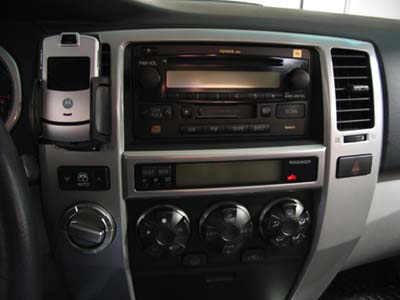

I just installed the ProClip for my Google G1 (TMobile). Great setup.
G1 holder is p/n 843868 with 3 in 1 adapter.
The bracket to mount to the drivers inside vent like seen in another post with their Razor IRON CLAD LOU is p/n 853562, this simply clips into the vent opening, very secure.
This is just too easy and effective to not do it for $100 for both parts.
Bonus. The mount has 3 jacks, really 4. Your phone plugs into #4.
1) is a usb port to provide power to your phone.
2) is a jack to plug into your 4R's mp3 jack. Your output sound goes into the vehicles stereo, even your phone calls. Need to use AUX on the stereo.
3) is a head phone jack. The G1's headphone has an adapter with a microphone, most phone probably come with this. Plug this into port 3. I taped the mic to the top of the steering column with black electrical tape.
Far superior to Bluetooth in my humble opinion.
If your want to hear the music on from your phone, press AUX on the stereo and play on your phone. If you want to receive or place a call (while in AUX), just do it. The stereo, really your phone, pauses while you take the call.
One issue is a buzz your get from the power adapter. There is a bulletin from Toyota to get it fixed. There is a post for this in the last couple days. I bought the inline filter from Crutchfield before realizing Toyota has a fix.
