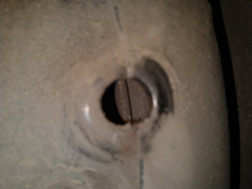

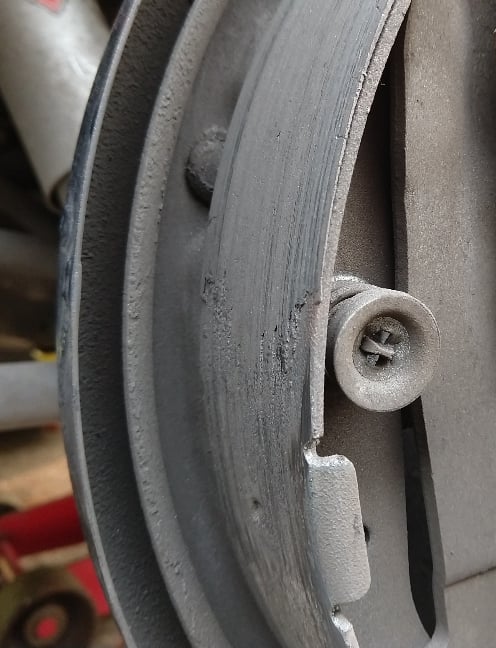

New twist during test drive. I had my window down and noticed that there's a metal scraping noise coming from the back driver side wheel during braking and subsequent forward motion. Took pictures of the rear shoes through the witness holes on the rear dust shields. Not sure what I'm looking at though.

Best to pull the rear drums as you’ll be able to get a better assessment of any issues regarding the condition of the shoes as well as other brake components and if any seepage from the rear axle seals.
Pad thickness window. Is what you are looking through. Check the drum lip shield. They rust off in my areas but they can rub the drum as it spins and make noise.
Also I agree it's always best to take the drum off and look things over.
If they wont come off you may have to take the rear center grommet out and use a brake tool screwdriver to back off the adjuster to get the drum off.
Sent from my SM-J337V using Tapatalk

Yeah, I get it's to check pad thickness but I can't tell what's the pad, whats the metal the pad is mounted to, and what's the drum.

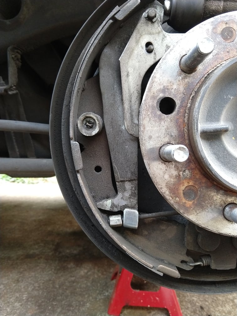

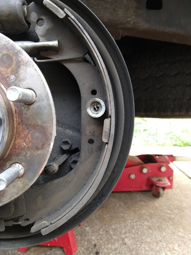

Pulled the drums and found this. Haha. Any thoughts on the front shoe being down to the metal with plenty of meat on the rears? It looked like the front shoe was sitting low in the piston while the rear was pretty well centered. There was also a TON of brake dust just sitting in the bottom of the drum. Seemed odd to me. Guess I know what I'll be doing on Sunday.

Not adjusted properly or the wheel cylinder has a plunger stuck.
You found your sqeek.

Don't they self-adjust every time you pull the e-brake?
Sent from my moto x4 using Tapatalk
They do, but only if your bell cranks aren't seized and the parking brake is adjusted correctly. New wheel cylinders for the rear are cheap. I got mine for $20 each. Make sure to replace your drums too.
The bell cranks seemed loose and mobile but I'll go through the e-brake adjustment just to make sure that's OK.
I was hoping not to get into replacing the wheel cylinders since they're not leaking but I guess it couldn't hurt.
Kind of going between refreshing everything and just getting the drums resurfaced and putting new shoes on.
These E-Brakes are notorious for not self adjusting. Were the adjusters even or did someone have one out twice or 3x more then the other side. If the wheel cylinder plungers are moving freely. I would check that bell crank or the E-brake was stuck on burned the pad off. As the pivot point in the bell crank is always freezing on these rigs.
