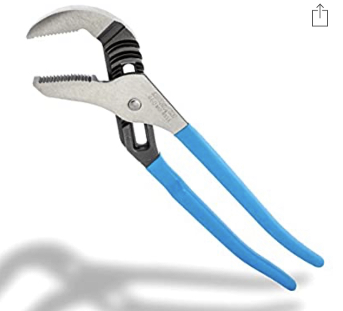

If you have a bigass channel lock pliers you can hold the housing (while still installed on the truck) while removing the filter drain plug. The metal housing does not come with the drain plug, re-use your original one. Use the proper torque for plug and housing.
