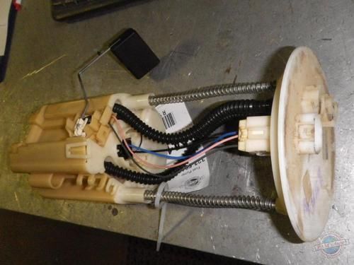

Jeff, this is what I see on line for 2005 circa fuel pump assembly (this is on fleabay for a v6), not sure what the v8 assemblies look like.
You can see the hoses. I suspect you can order a couple feet of gates submersible hose, grab some fuel injection type screw clamps and be done with it for not too much cost (maybe 50 bucks) - IF that is the problem.

Thank you so much for supplying that picture. I am working on getting a schematics of the tank assembly. I was under there this weekend looking for that pump, but I assume its on the top of the tank (I had my tires off for rotation). I was thinking about just replacing the entire fuel pump. Do you think that would be ideal? I will definitely post a writeup/solution once I get around to this problem. Waiting for some decent weather and time to get this project started.
