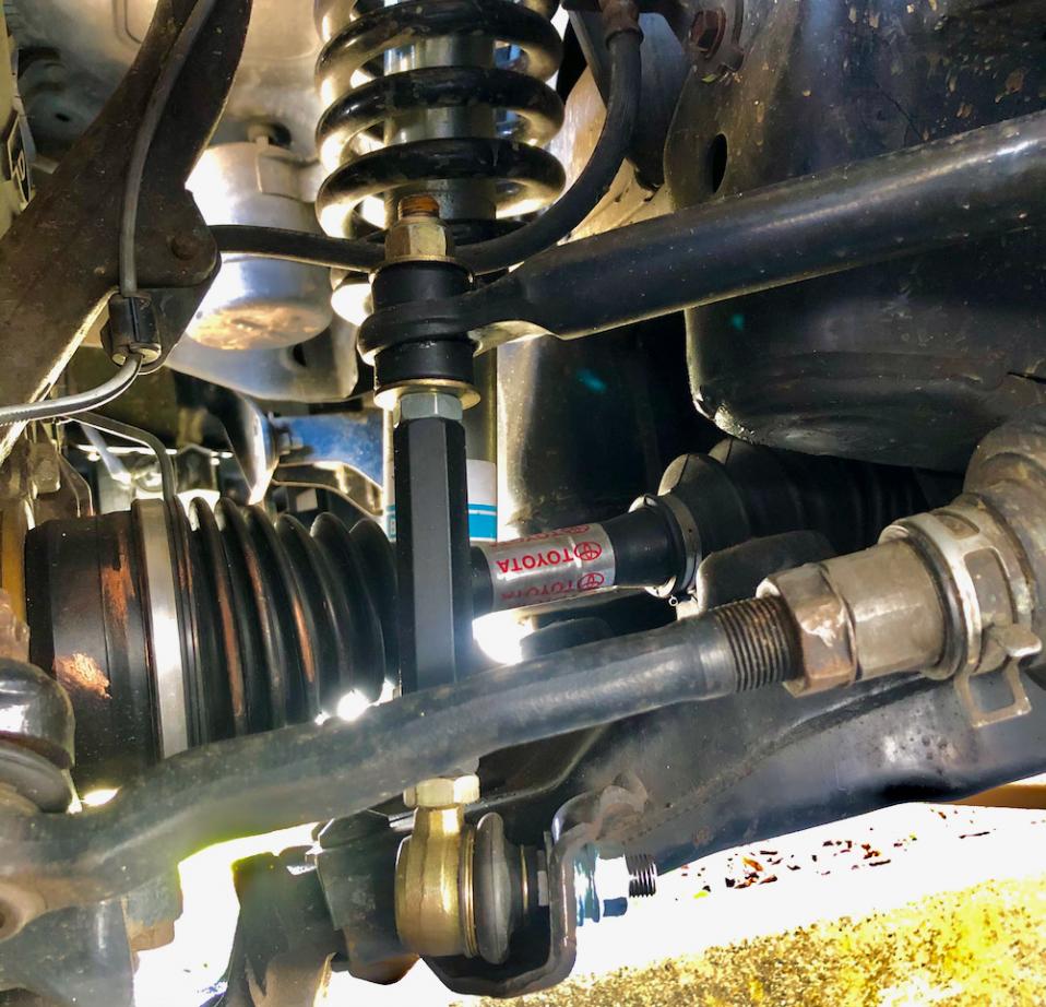

I was under mine at lunch a couple hours ago in my work parking lot....you don't need to go fancy on the end links but I couldn't help myself....

What brand of end link is that? Does it use a heim joint in the bottom?
This version has a forged ball joint rather than a Heim joint. These are longer than stock length, however. I wouldn't bother unless you have a 2"+ lift. They are adjustable, but not sure if that means the length can be shortened much. They are not cheap. They are made in Oregon by a forum member's company called Overland Custom Design. Did I mention that they are not cheap?
