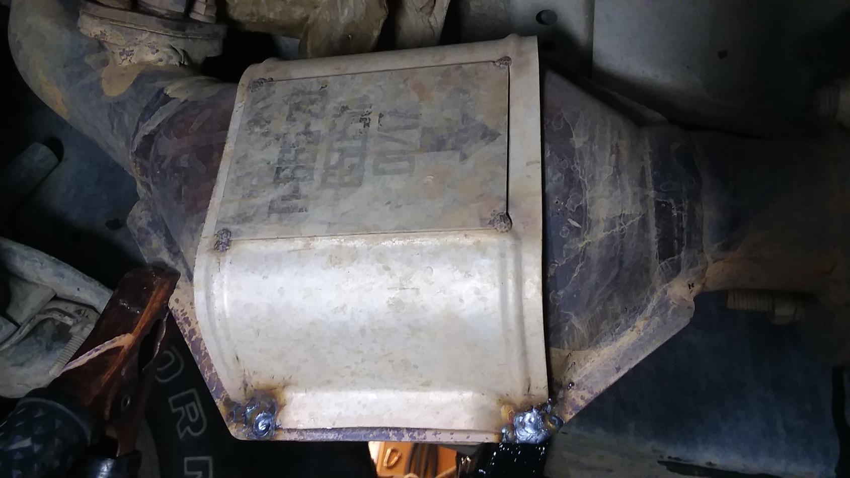

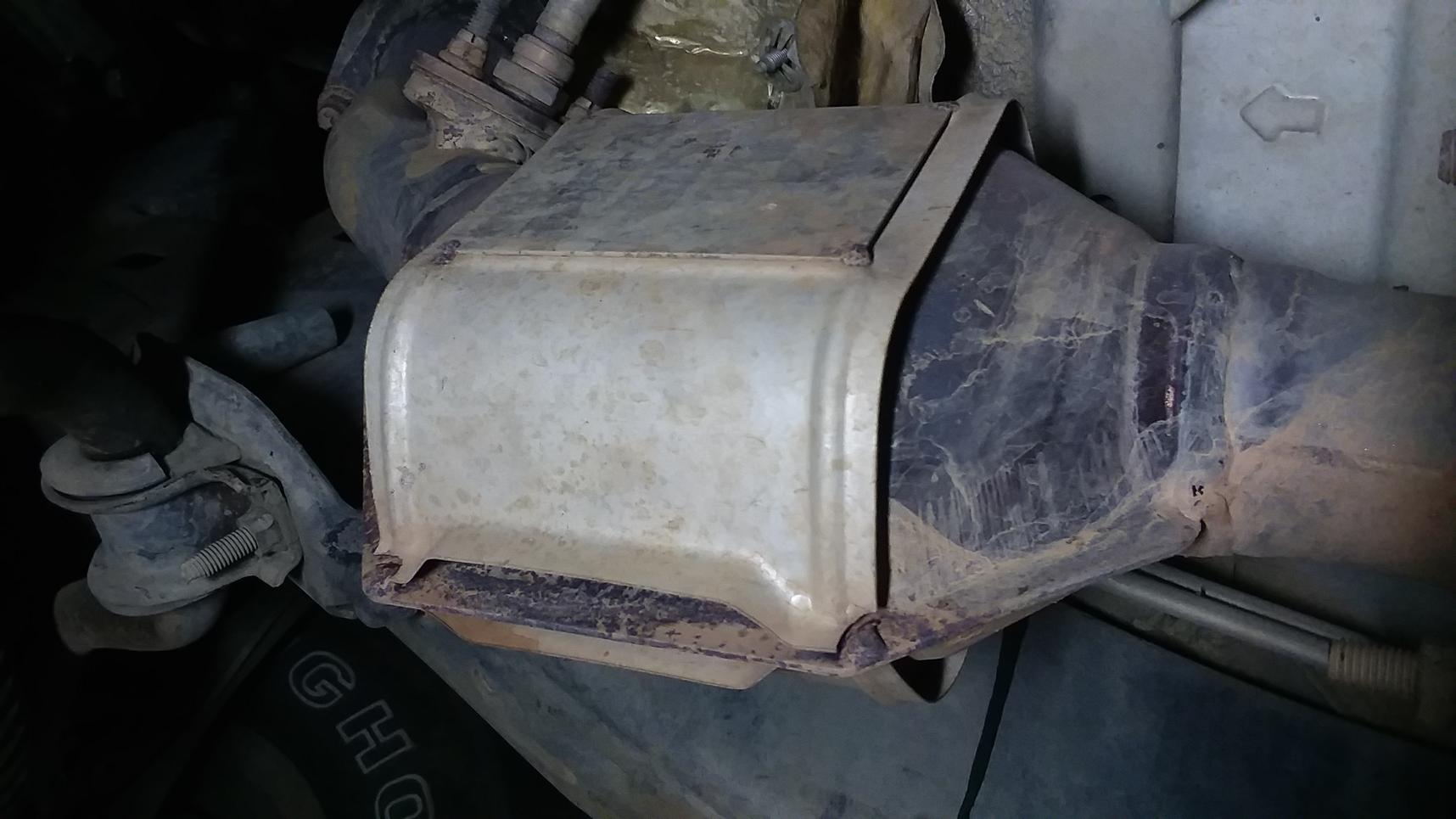

I had a similar sound, It was the cat heat shield on one side. Two of the four tacks that hold it on broke. I retacked it, no more noise.
