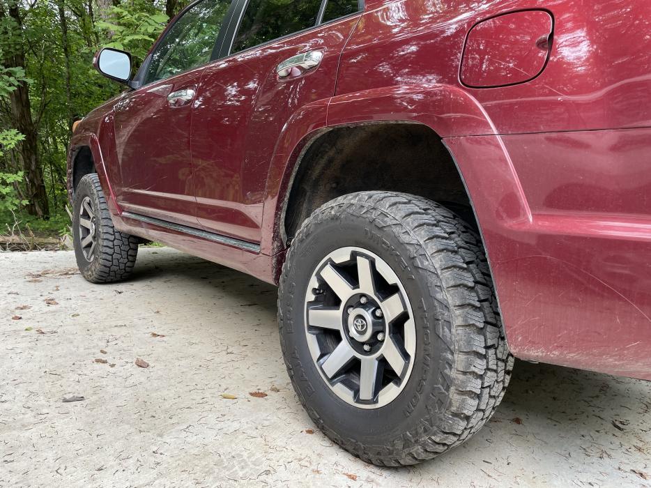

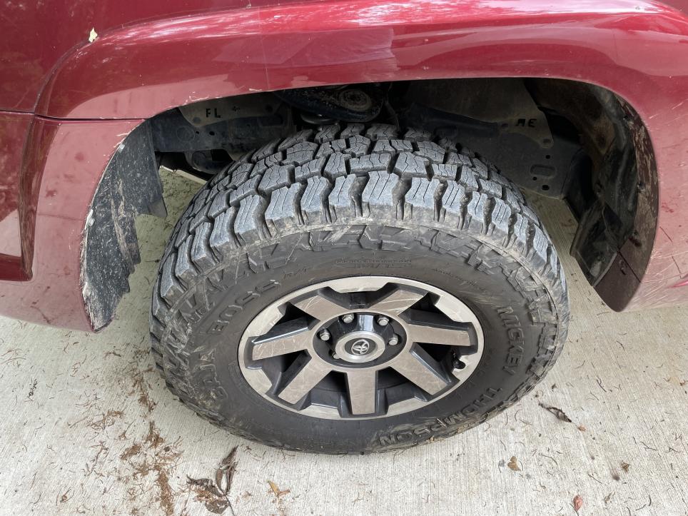

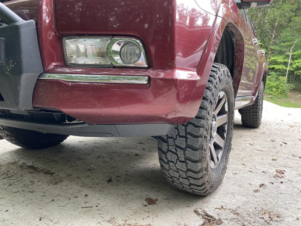

I finally purchased these for my 4runner this summer in the stock 265/70-17 in the XL load rating. So far I'm very happy. They are quite a bit quieter than the C-rated Duratracs on my T100 (which is out of alignment and has been for many miles, contributing to tire noise). Overall, these fit my needs very well striking a balance between off-road/on-road performance, weight, etc. The tread voids are slightly smaller than the Duratracs, but I really like the variable sized tread voids on the shoulder lugs. This allows for some large spacing for mud traction, without the compromises made of using a mud tire on-road.
One thing to note, is that the XL rated tire does not have the rim protector that the E load rated tire has. This was a bit of a disappointment as I have found mud/rocks/sticks to find their way into the tire bead without a rim protector.
I came from Michelin LTX's on this and there of course more noise, but it's not significant. I have to think about it to recognize it. MPG likely dropped slightly, but I did a lift at the same time, so I can't really say which contributed more to that. Dry road traction is a bit less on hard braking in my experience. I did have a close encounter with a deer that engaged the ABS, but all was well-enough...I also had a trailer on without brakes which contributed to the fudgy pants potential. Wet road traction is amazing so far. We hit some serious deluges in WV heading home on the interstate from vacation and I was really impressed by their performance in the wet.
I'll attempt to include photos in a separate post. I seem to be having trouble getting them uploaded.
