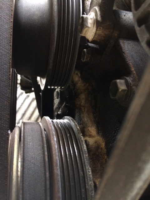

Also, I got a better look at my water pump today. Here is a pic taken from under the car. You can see a white streak of something (coolant?) has been coming out the bottom of the pump. Does that mean its busted??

the pump is leaking.
but based on your description, it sounds like a classic head gasket to me.
do the HG, and pump.

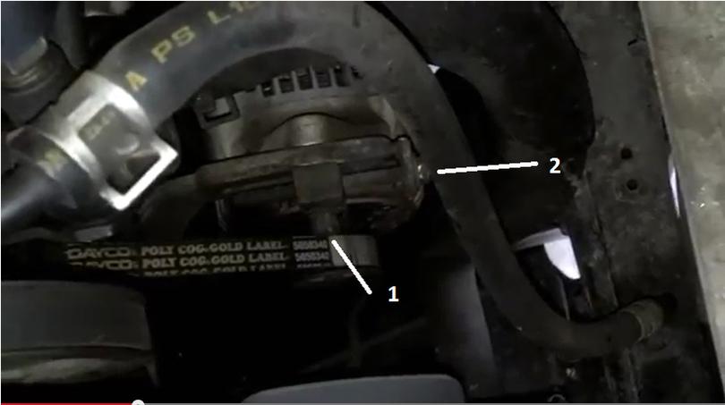

Here is a tensioner on the alternator. So I understand correct, I loosen bolt 1 and then 2, correct? do these bolts come all the way off? And that's it, I can lift the belt right off there?

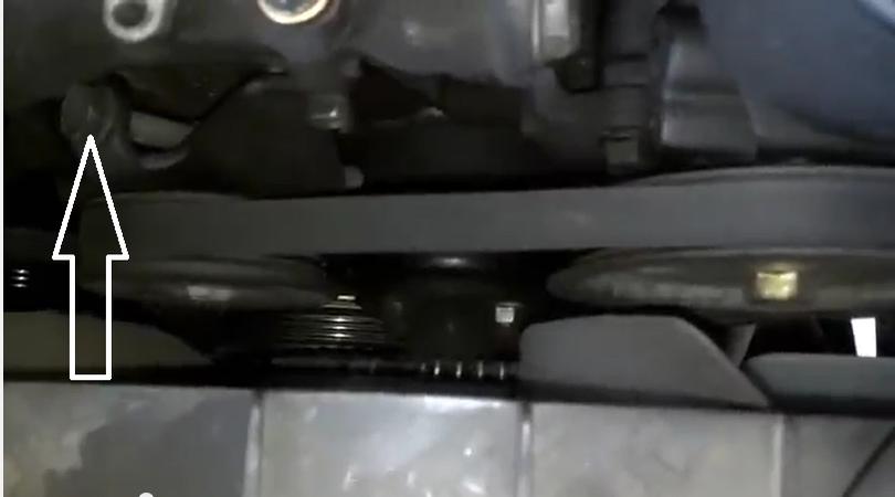

Here is a pic of another tensioner on the top with one of those long screws. I was working on taking it out and the screw snapped in half. Am I screwed?! No pun intended. This thing is going to fight me the entire way.

Yes, loosen #1 and then #2. When they are being stubborn use penetrating oil and let it soak for a while before you start really cranking on it.
