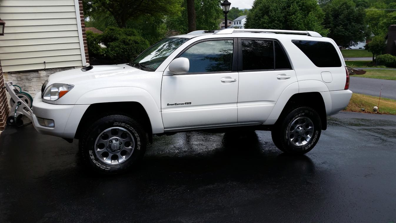

No regrets, I'm on a slight decline in the pic but that'show she sits. I'm probably going to add 1/4 spacer the front in the next month or so. So I'll post pics when I do that. (I do not have exact measurements on me currently, sorry).

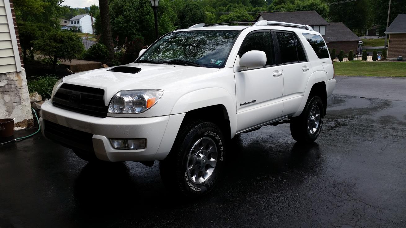

Here you go. 2006, V6 - full OME with 883/895e. Running stock tires until I wear them out.
I love the setup as is. Rides great off road. As mentioned, handles extra weight well but also minimizes body roll and nose dive. I don't find it uncomfortable, it rides like a truck but is noticeably smoother with a load. Very happy with the setup. I started with 884s up front and my wheel wells were almost level. I dropped to the 883s and lost exactly an inch up front so I have the 1" of rake like I wanted.

I ended up speaking with ARB USA after my initial install. Their take is that the 895e was never meant to be paired with the 884, only with the 883s. They are the same spring rate but 883s are 10mm shorter, about 1/2". That yielded me a 1" lift difference after install. I had talked to several vendors before purchasing. Toytec for example does not list 883s as an standard option with 895e when building an OME kit for 4th gen T4R. In fact I only found them listed as a Taco option. After my experience I provided feedback to them but I don't think they made any changes. :shrug:
Very interesting. Well your 883 set up looks great. I already ordered mine to swap out :lmao:
Does your front suspension have any other mods/upgrades? Or just the 883 springs w/ OME shocks? (such as trim packer for driver lean?)
I do have drivers side trim on the front. I ordered rear just in case but I am only 1/4" lower on drivers side so I consider it level.
