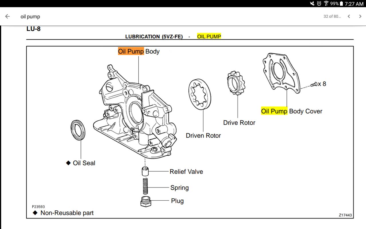

my bad I meant to say oil pump
Do you by chance have the old Toyota OEM pump lying around? When I changed out my TB and all some time ago I ordered a new Aisin fan bracket. Two months later I was getting a serious noise from the bearing. Put the old OEM back on, no more noise. Aisin, while a great parts supplier, isn’t immune from defects.
